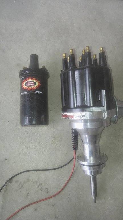

I have a pertronix ignitor 3 billet distributor and coil for sale. Has about 50 miles on it. 200 plus the ride. This will give better spark and cleanup the firewall a bit.
