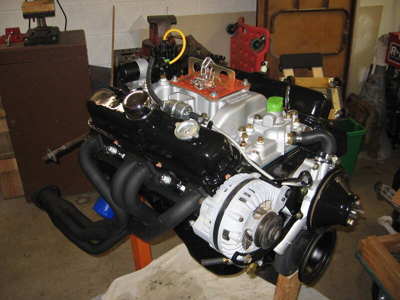

These are Summit brand cheepies. They went on my 63 Belvedere (I replaced the poly) with a 1970 318.
No problem and no oil filter adapter.
