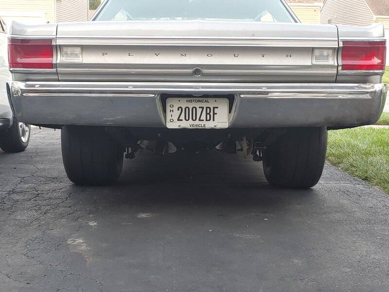

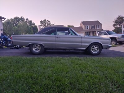

This is with a mini tubbed shorten D60 with 10 inch rims and 5.5 b.s.. I can fit a 12 inch rim with 6.5 b.s. it's the way the quarter panel rolls in is what we have to watch out for on the 66-67 Plymouths
4.75" to 5" BS 8" wheels more BS than 7". Had L60 x 15" 7" wheels 4" BS rubbed. The concave area is the problem area.
