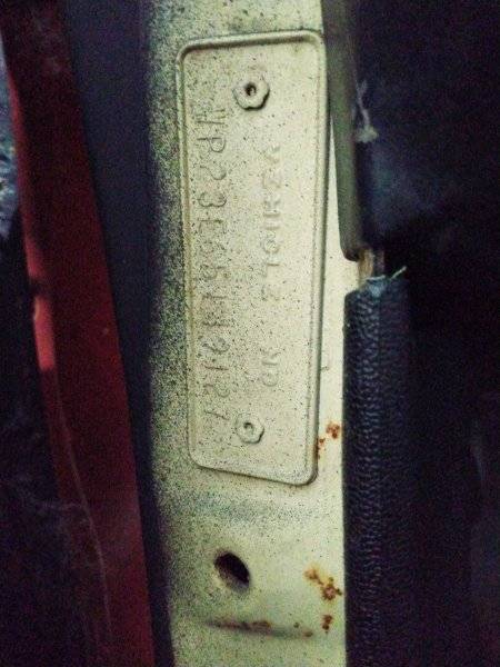

Question for the VIN guru's regarding my car, 1966 Coronet. As best as I can tell from the VIN, WP23E65****** (W) Dodge 117"/118", (P) Premium, (23) 2 Dr Hardtop, (E) 6 - Special Order, (6) 1966, (5) I have no clue, then a 6 digit assy number.
2 Questions: Does anyone know what "6 - Special Order" means?
and, What does "5" mean in the 7th position, shouldn't that be an alpha designator for the assembly plant?

E= 361 engine
5= LA California assy plant
Alpha assy plants started in 1970
E= 361 engine
Thought that was the misprint bulletin. E is actually a 318.
Or else my 66 is finally a 361!
Yep. E is 318 in 66.
As noted the 1966 FSM is wrong.
The same error is in BOTH the Dodge and Plymouth FSMs for 1966, so folks know.

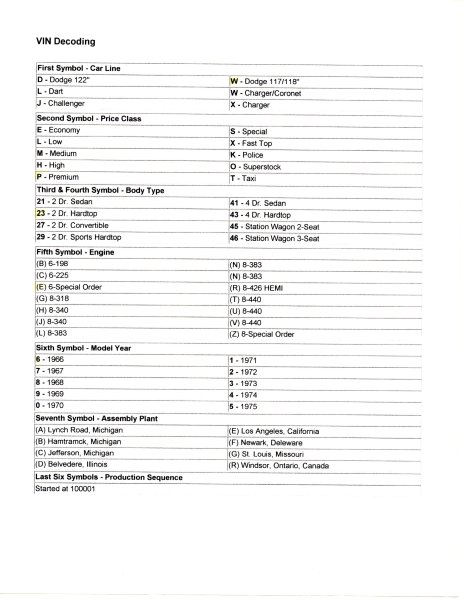

Sorry. I miss spoke, the 5th digit "E" in my VIN was the one in question. I attached a pic of the paper I was using, and it says the E in the 5th position = special order. I don't have the fender tag for my car, so this is all I got to go with, just trying to learn a little about the cars history and where it came from. Seems like there's a lot of different info out there for pre-70's cars
Someone just smashed a bunch of different years info together. Ditch that whole article and look at 66 info only.
That looks like a 1970 engine VIN digit chart.
I believe we addressed the OP's main concern way up at the top of this thread...
...several times.
Here it is again-
There is an error in the 1966 factory service manual.
The correct VIN code 5th digits are as follows-
C- 225
D- 273 (all 2 barrel engines in B body cars)
E- 318 (all 2 barrel engines)
F- 361 (all 2 barrel engines in B body cars)
G- 383 (all 4 barrel engines)
H- 426 Hemi
