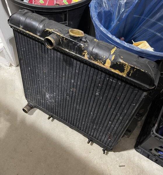

Okay, 67 gurus, I need some knowledge dropped on me. I have a 67 coronet, 383 / 2v. I believe I have a 22' radiator. I'm not showing the 26" on my fender tag. Question: all the reproduction radiators seem to be 26". Can I run a 26" without modification, i.e. will it be a drop in? will it mount up properly? is the core support the same? can I run a newer radiator as a direct drop in replacement?

Looks factory except the 4" that isn't opened up.
I'd like to see this bracket that downsizes a 26 to a 22.
The core support is not the same. You can buy some look alike 22" radiators that will bolt in. I ordered a 26" radiator from Griffin with special hose locations by accident. I didn't measure the core support. I had to drill some new holes in the core support to center it up ,but it will work fine with my added AC. If you haven't spent money yet, get exactly what you need.
As @Aron Gleason said above, you can get a special bracket. No, it will not change the core support opening to 26". Direct airflow will cross 22" and there will still be some additional cooling effect by the covered 4". On the '67 383 2V cars, no a/c had 22" and a/c cars had 26".

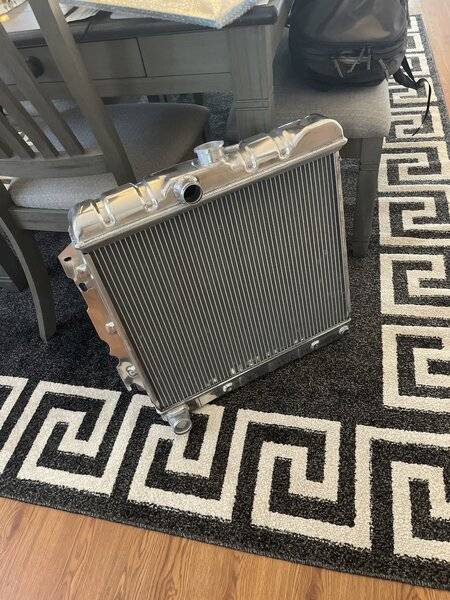

If I'm not mistaken the radiator that @Don67Satellite posted is like $229 and painted it's $279. You can paint it yourself for a whole lot less than $50. I have used several of these and they perform great.

Thanks, but my question was, "Is the core support for a 26" different from a 22" core support." Is the hole for the radiator bigger on the 26"? Or, does the 22" have brackets or baffles that close the hole down? I'd go look myself but my car is in the shop waiting on a new radiator.

Not identical to mine. The top hose nipple on mine is to the far passenger side, on mine (see post pic).
Yes, I was referring to mine.
You have the big block 22", my old one was the small block 22" as my car originally had a poly 318. So technically I got a replica of the "small block style" but it cools quite well so far for the 440. The only difference I see on these replicas, are where the top hose goes, internally they seem identical.
He has yours.
Yes, I have the BB 22". That's why my top hose nipple is at a different location. I'm sure it will work the same, just not look the same.
