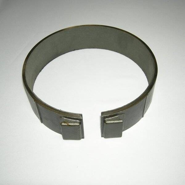

Lucky dog! When the same thing happened to me, the band's strut support had broken off.
Curious, was that a flex band with the formed strut support?
It was the stock style, looked like this one but not as heavy-duty-
never seen a cast anchor break on a KD band, reverse yes. Put one in reverse going forward.
