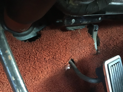

On one pic I can't see the pic close. On a 69 do you cut the carpet around the square brackets that is part of the gas pedal arm. Or do you lap the carpet over the roller

There is a hole for the arm to come through the carpet. That is a straight cut where the pivot comes back. It is spread open because that carpet is now 51 years old.
