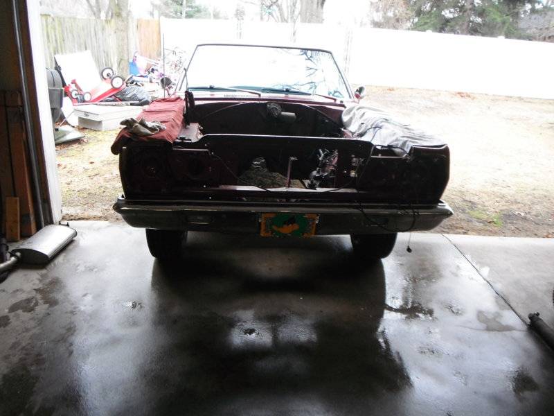

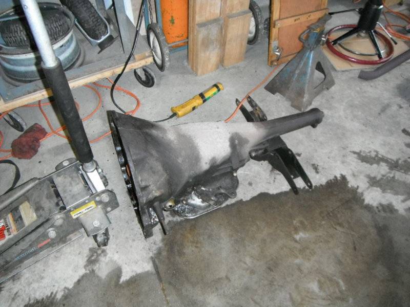

Pulled the engine and trans over the weekend getting ready to clean the compartment up in preparation to paint. Much work to do in my future here torsion cross member rotten so replacement is a must. Pulling the heater box to replace a noisy blower motor, pulling the instrument cluster to clean it replace light bulbs and attempt to refinish the silver trim with "paint pens". While the heater is out I'll pull the wiper motor to clean and do an amateur refinish job. I spend every other day out there so the job don't get to boring hope to get her together and onto the road and to the cruise-ins around here. The "Woodward Cruise In" is another goal for myself in the future.

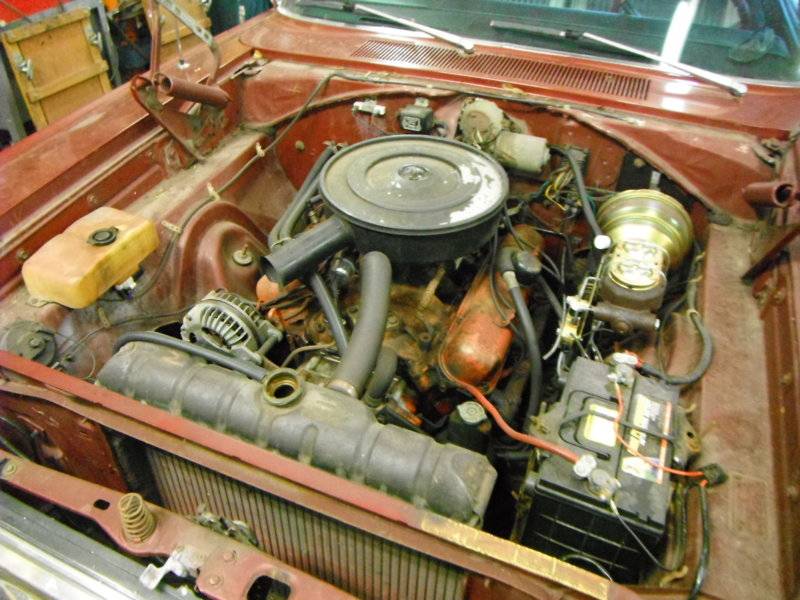

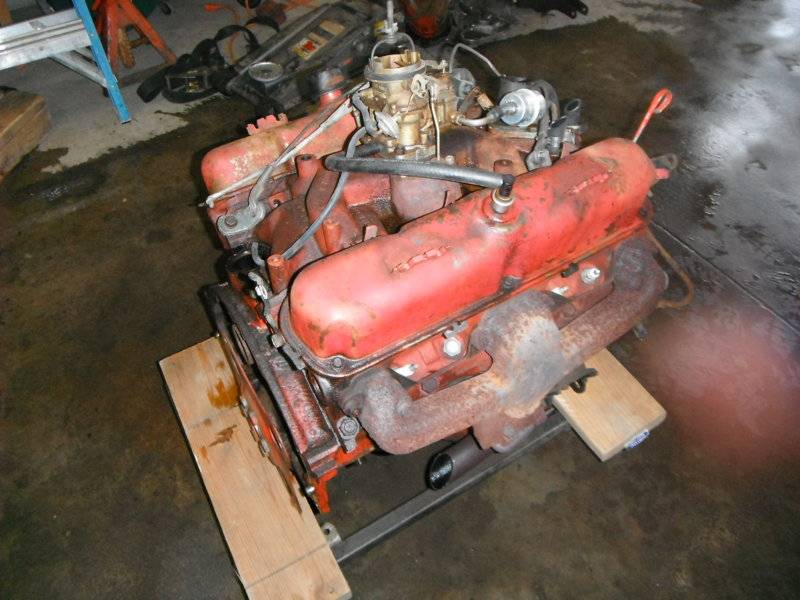

Engine and trans is for sale previously owned by lady school teacher from Carlton Mi. I bought it off her son who said the car sat garaged for ten years when I bought it. Has 66K on the clock but must not have been maintained as it has oil starvation on start up, noisy lifter till warmed up, rough idle maybe a valve issue. The transmission don't engage for a couple of seconds when cold otherwise warmed up it shifts great. Oil was not burnt and clean. Radiator air cleaner and transmission linkages etc comes with it. I drove it to shows and on the highway so it's a good buy if your putting a car back to original. I'm putting in a big block reason for replacing it. I'm in Toledo Ohio. $500.00 and I'm firm on that price.
