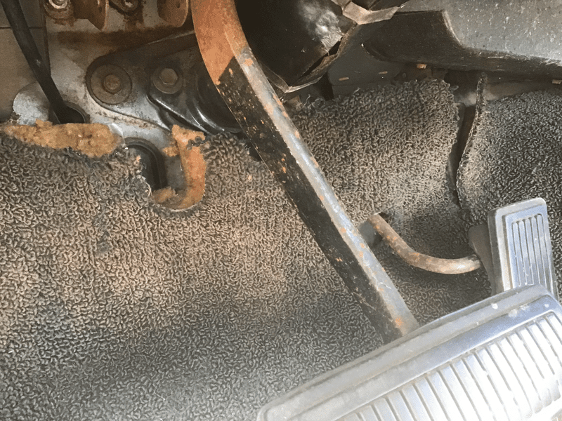

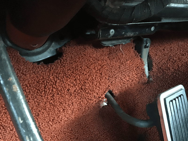

This is how that gas pedal is done. Hole for the gas pedal rod, and a cut for the moving bracket. That’s not a piece cut out just a straight cut.
1st photo 67 coronet
2nd photo 70 sport satellite
These are original carpets
then a half round cut out for the clutch rod and column.

that is what I was trying to describe, maybe not enough coffee,,,,,,but that cutout does not exist in an automatic, and that padding is well made, not like what a person is sold today.
These cut outs are the same for auto and 4 speed. I have a 4 speed with original carpet but can’t get to it for photos easily.
the reason an automatic carpet has a clutch rod cut out is because a coulmn shift manual has a clutch rod and the same floor and rug as an automatic.
We don’t need to cut it on and automatic but just showing what the factory did on them to be correct.

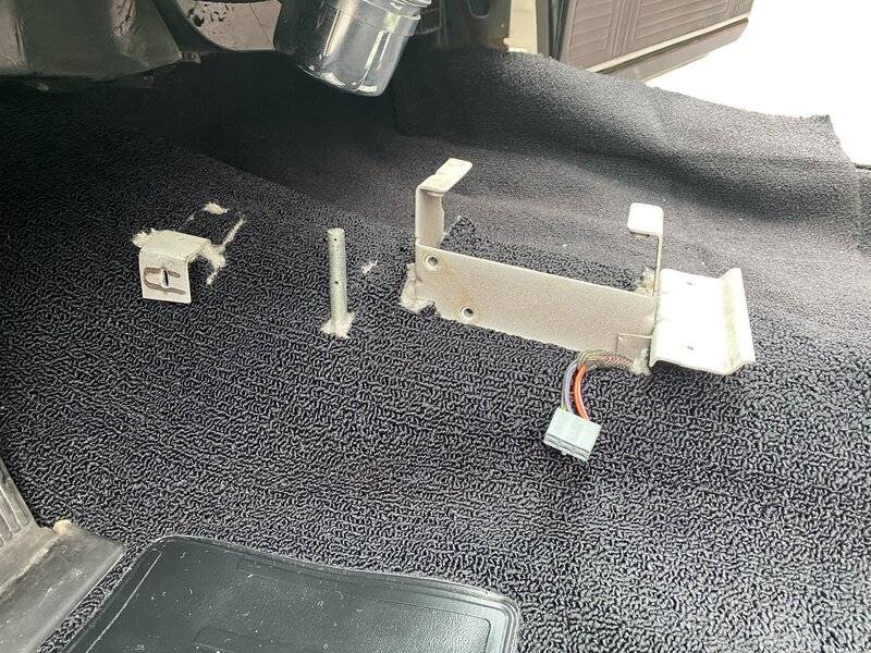

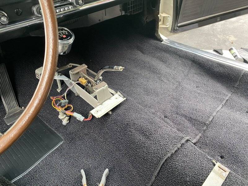

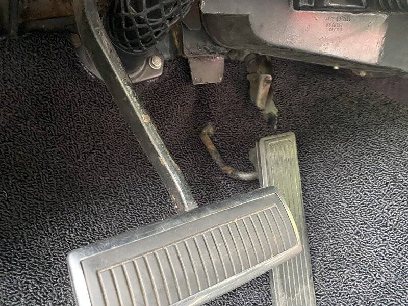

Well I would not have guessed that. It was like that but I assumed it was replaced before. Seemed like too much carpet around moving pieces. I figured it has to be wrong , danger of carpet hanging up the throttle but I’m mistaken . Thanks
@R413 i did it as your pictures showed. Made a little bit of a V around the arm that holds the cable to give me piece of mind.
