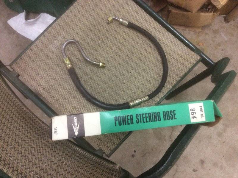

66 Satellite hose for a hemi don't think you'll find one. Pump end on left.

As long as the ends are correct and it's not too short you should be good.
Power steering pressure hoses are very application-specific. There are more universal type of hoses that can and will work, but the routing may be different than oem. This may be what you're after. This runs down towards the k frame before going to the steering box fitting, keeping it away from the manifold, assuming you have a Federal/TRW style pump.
1967-68 Chrysler w 4 bbl Carb Dodge Polara Monaco 440 383 PS Pressure Hose | eBay
Thanks, but I have a Saginaw style, with that pesky "O" ring end. This looks like a flair type hose.
Is your pump original to the car or is it a 69-up style?
