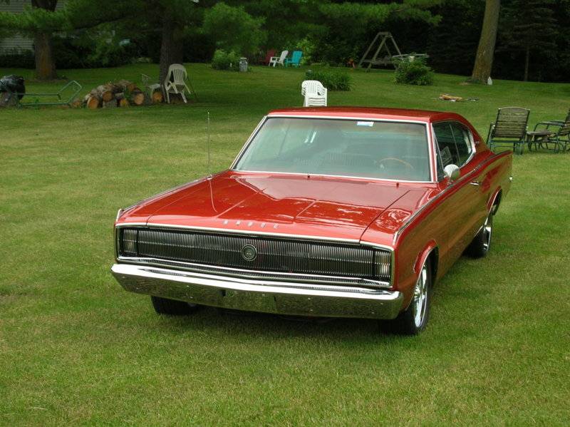

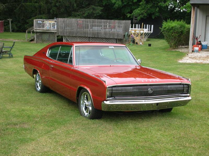

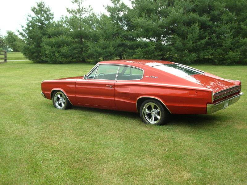

Thanks Guys.....I have been recovering from a surgery, so sorry for my delay. I had a couple cans of SEM 15243 that I used for all my plastic and vinyl repaint, so I used the two cans on the headliner. I was really surprised as to how good it turned out and it did not rub off. Waiting on the interior metal to get re-chromed….and than I can say I have completed this car ….yippee

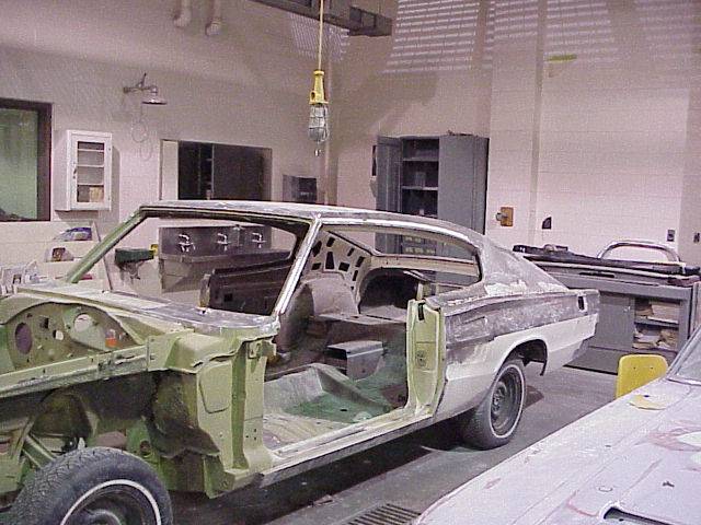

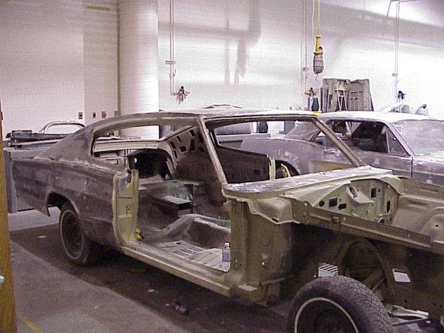

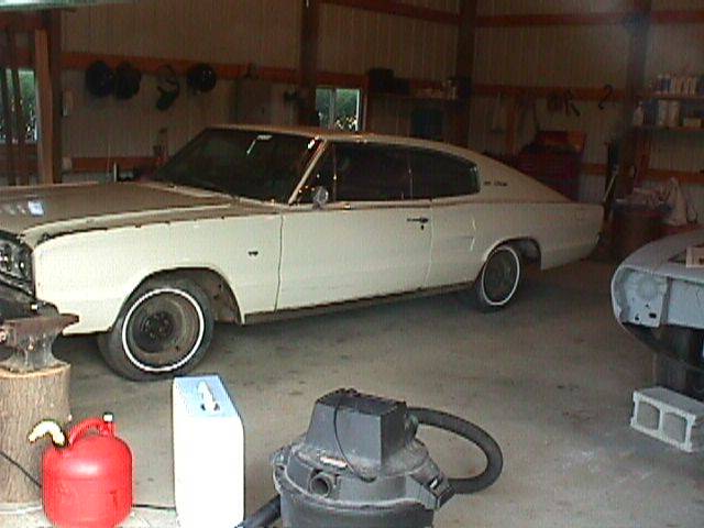

Found a picture of the car when I brought it home 20 years ago and a couple of my son working on the body in 2004 at the high school trade school.
