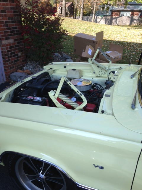

see pic for how it looks as purchased.....

dirty under hood...not as pretty as rest of car. so this will be taken care of before hemi go's in...

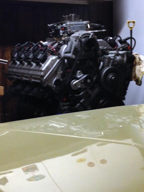

engine: 04 Durango engine, stock, 43k miles, modman indy intake, fresh valve job on stock heads.
im thinking from what I have read motor should already be around 360-370 hp? with good carb.
