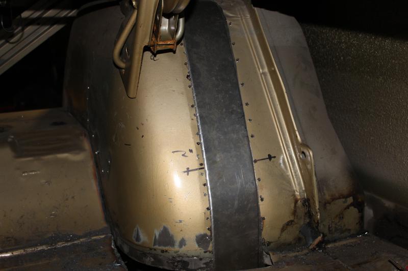

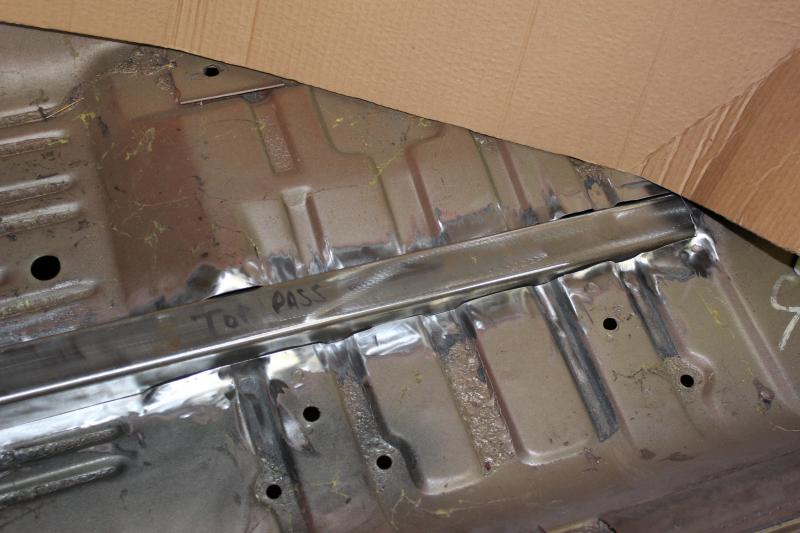

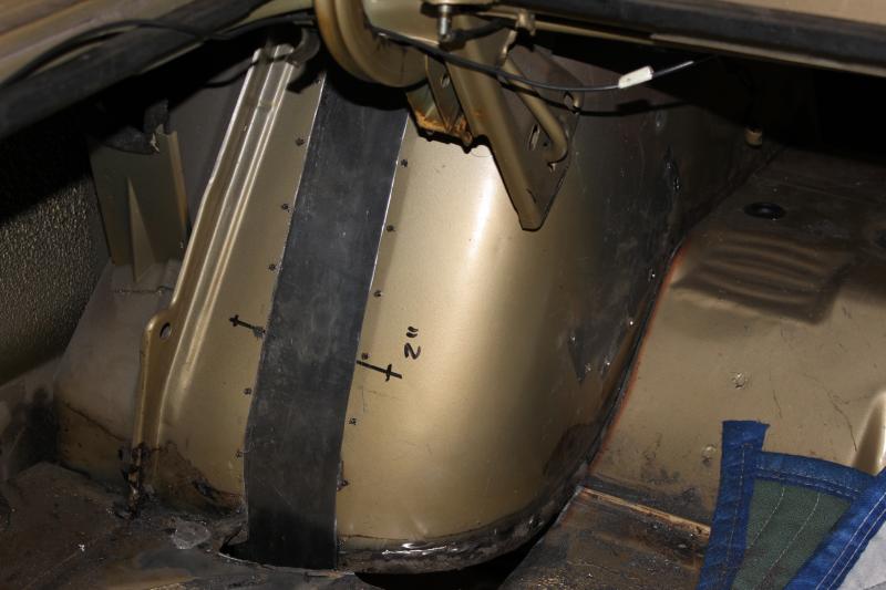

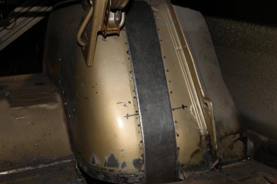

Nice shape. Love the 66 / 67 Nets, looks great! But..........why the heck did you have to show the mini tub? I've been thinking about it a lot and now seeing yours, damn it, it doesn't look too hard. Is it really as simple of a job as it appears to be? Shoot, and just when I thought I was done underneath the car, maybe more work on the board. :BangHead: What did or are you going to do with the seat belt mounts?
Subscribed..........
'Simple'. Depends on level of competency, but there is a lot of work involved, methinks. Not exactly the word I would use for it.
This build looks like it's starting out awesome. Excited to see how it evolves. What's your timeframe?
Herr is right gdrill... time consuming for sure. For me the benefits of bigger meats outweighed the effort though. I did an awful lot of measuring and planning before I made the first cut. If you have the skill set, I say go for it! '67 wheel wells are sorely lacking in real estate and it's a shame because they look sooooo good with a fat tire. Seat belt mounts are going to be relocated inboard of the tubs. Herr, timeline is flexible. My desire says it will be done this year, my work schedule and my wallet say otherwise...
Thanx sclee440. I have the skills to do this, just when I saw yours it made me realize it wouldn't be that daunting. There are 6 steps that I see, more or less. 1 - cut the trunk spring mounts, 2 - cut the tub, 3 - cut the floor, 4 - re-locate the seat belts, 5 - weld in the spacer, 6 - re-attach everything together. Of course measuring everything carefully along the way. I may have simplified this, but I believe it's close. I have two questions though. Re-locating the seatbelts: The tub is moved right to the frame, or very close. Are you installing them into the top of the frame rail? Next, do you have to modify the back seat for this modification? I like the way you sectioned the spacer in by crimping both sides, at least it looks like that. That should add a lot of strength and actually be quite sturdy.

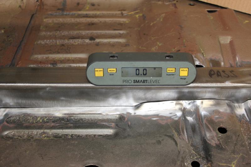

Love the fab work!! Everything looks great!! How do you like that digital level? Does it seem accurate?
The level works well. It has a calibration procedure that's a bit of a pain, but I do it every time I use it to make sure it's accurate.

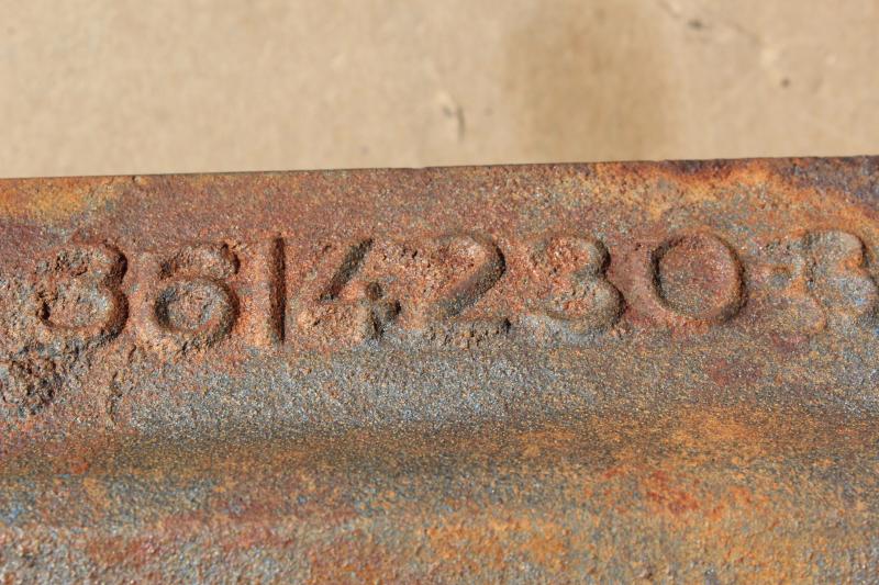

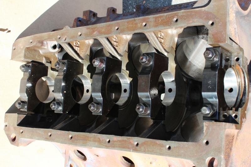

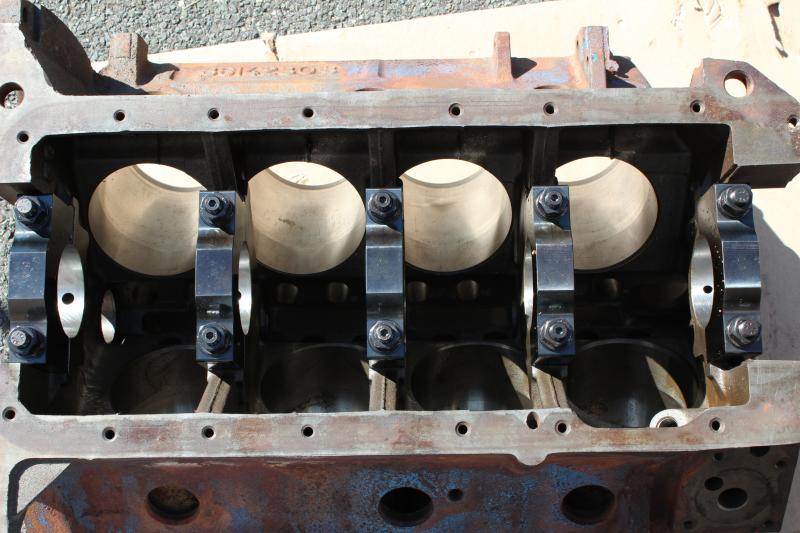

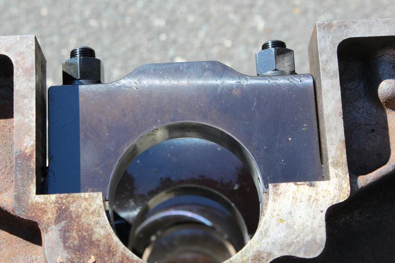

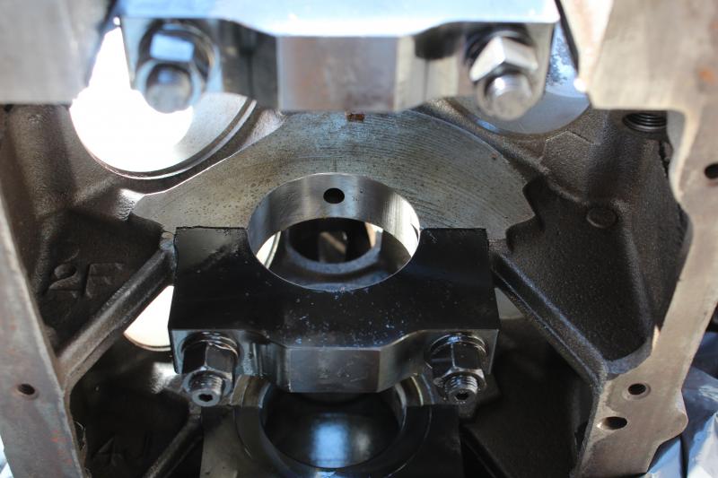

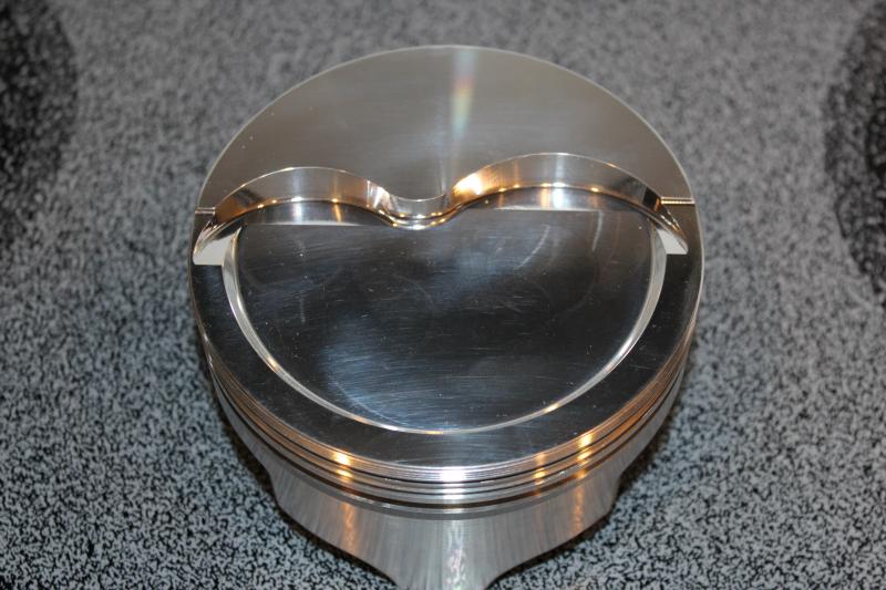

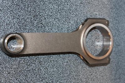

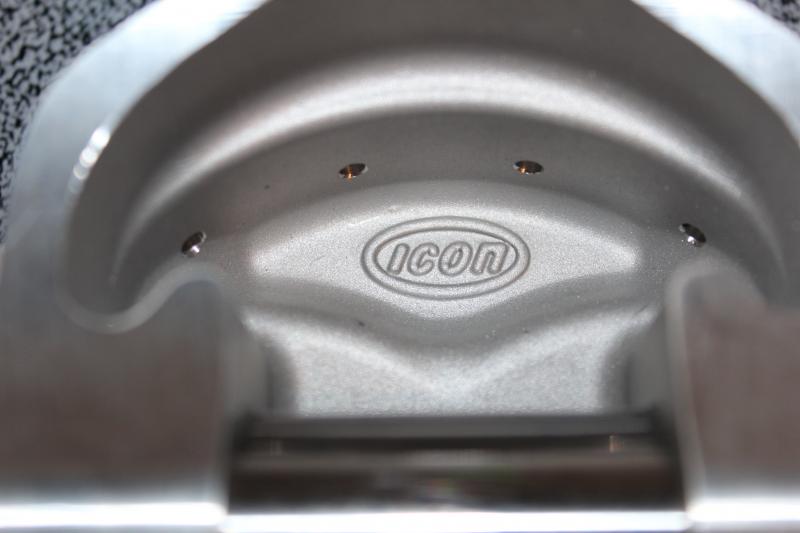

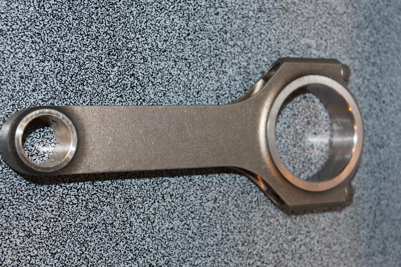

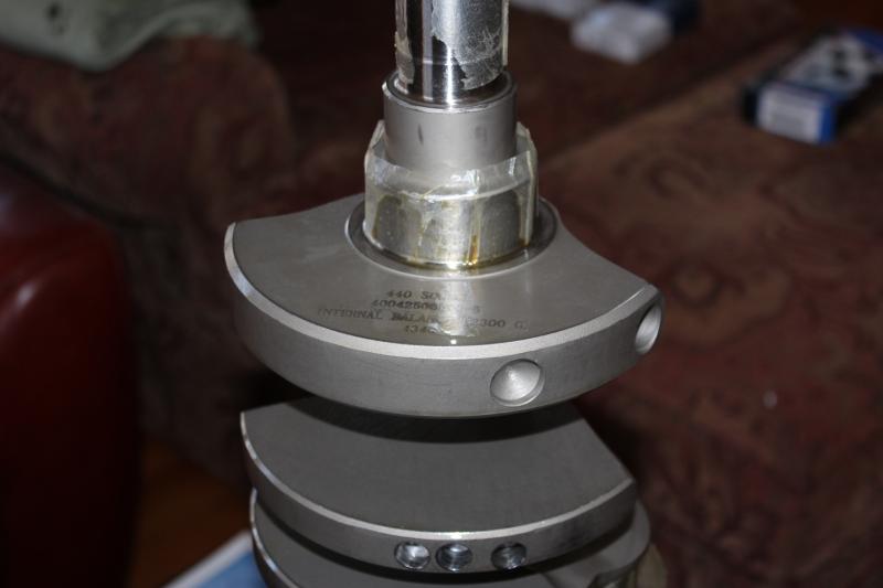

Very nice.One day I would like to tackle this.The tub and frame rail job that is.
did you have to modify the inner wheel house to clear the trunk hinge? i did the same mini tub on my 67 satellite and had to "notch" the inner wheel house. that was somthing that i did not take into consideration when i set out to do the job.

Yeah, had to modify the wheelhouse to clear the hinge. Looks like a big rough dimple at this point. I'll clean it up later and make it look more presentable.
