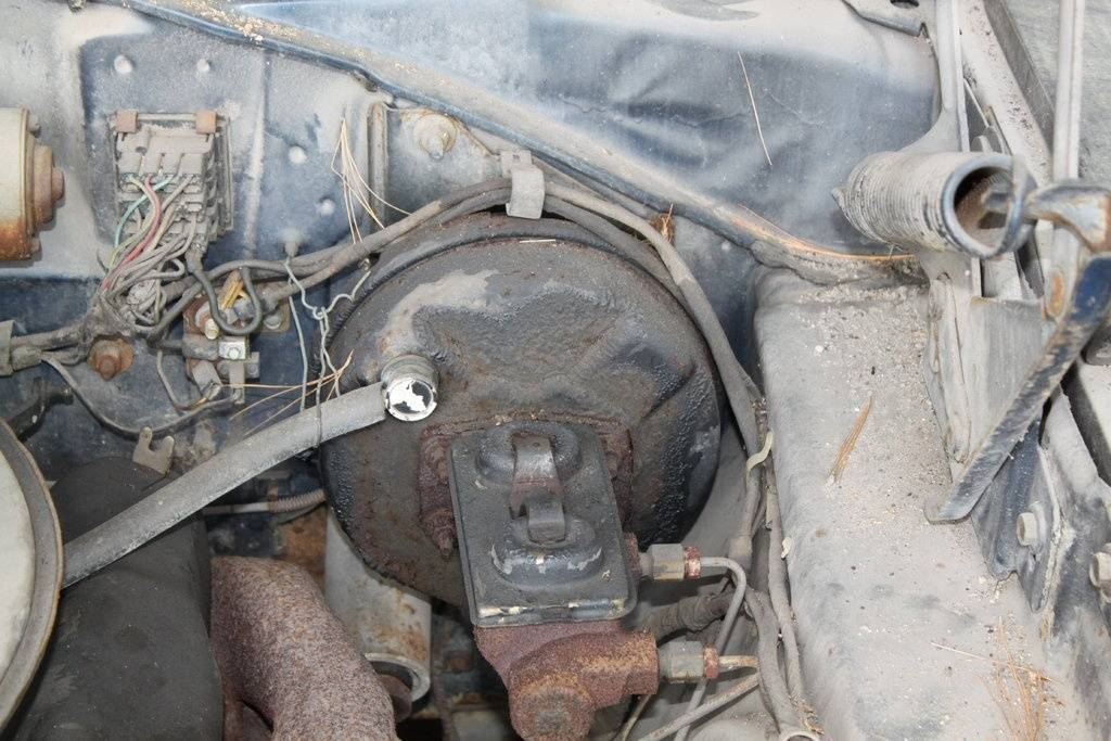

I recently picked up an R/T that has 57k miles and has been sitting since 1980. I cannot seem to figure out what this booster is, Bendix etc. Also the MC has these fitting between the lines and MC, I've never seen these before either.
Both fender tag and broadcast sheet confirm this is a power drum car.
Can anyone confirm these items are factory? I have no reason to believe they are not original to the car but I don't see a match to that booster in the FSM or a reference to those fittings.
I'm guessing but the brass fittings were common when a replacement master was installed that had different thread sizes. I know there were 2 boosters used midland and bendix. Not sure which is which.
Those are the ones in the FSM but neither look like this one.
Guess once I'll get it out we'll see what's stamped on it.
Car was in service from 67-80 and 57k miles. I would think these would be original to the car, or maybe not.

No mystery solved yet on the booster but I was able to visually match it up. Looks like a booster from a 69 C Body. Once I get it removed I'll look for part numbers and date code.

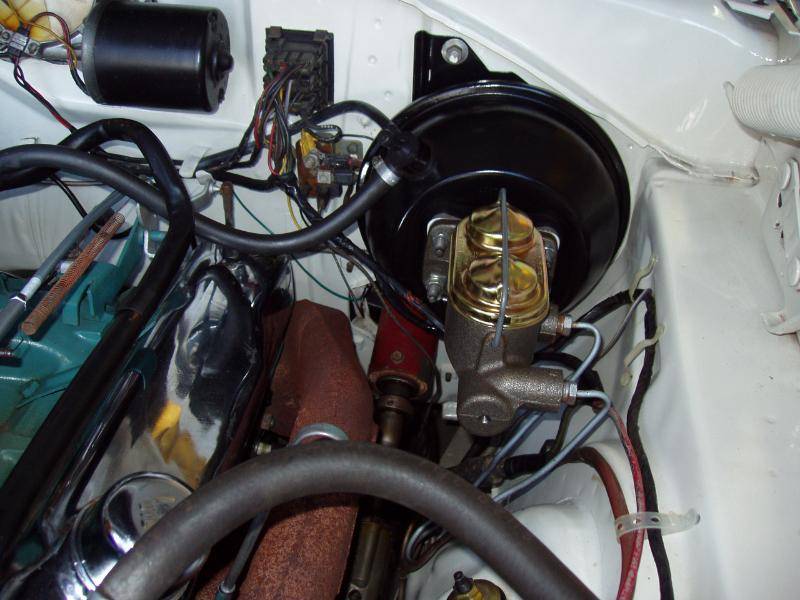

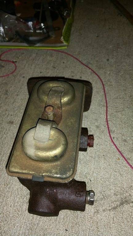

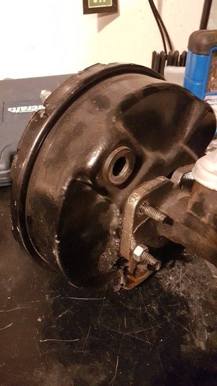

My booster looks just like that and the master cylinder I just changed out looks like that one too but I don't have any adapters. 67 Coronet R/T
Thank you! So if Big Al has the same one then I think I can absolutely call it original for sure. It's also interesting that the MC cover is gold. I saw that on mine too, somebody painted over it at some point but I thought it was interesting. I'm not sure I've seen any restored cars with a gold cap.
I guess the big question is, why aren't these boosters in the FSM? Closest thing I could find to match this booster is a 69 C body.
The booster is a single diaphragm Bendix, which is correct for heavy duty 11" drum brakes. I have the same unit on my early '68.

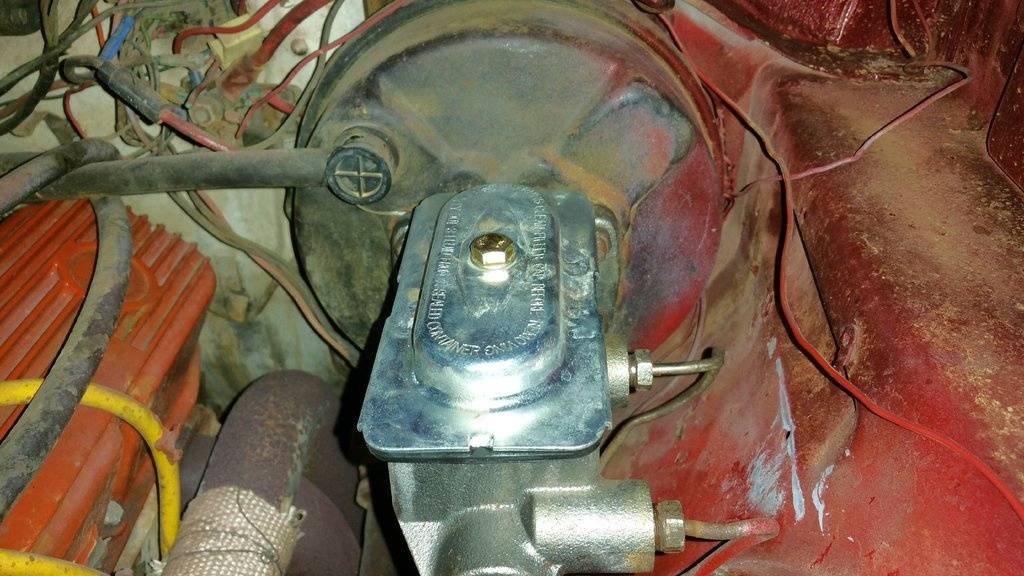

Can anyone identify this one? I purchased it used and installed many years ago. Thought it was off of a 68 o 69 B-Body but not sure. It's not over boosted or touchy by any means. MC is a NAPA replacement.
That one looks like a Midland Ross that's in the FSM and also the one that's available as a replacement from most parts houses today.
