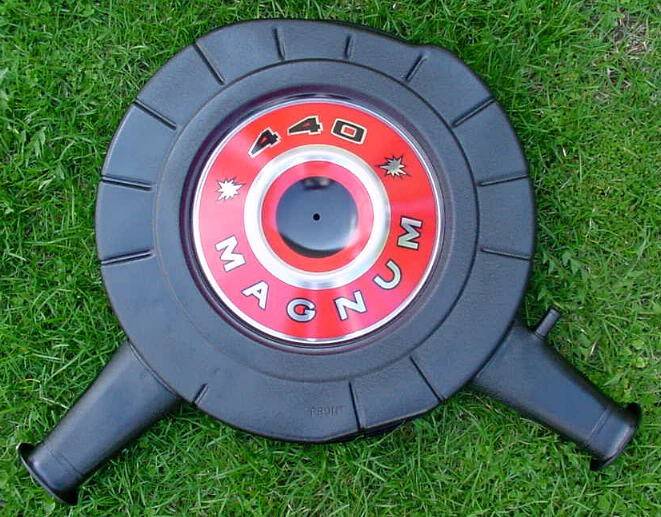

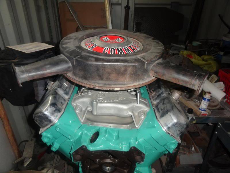

Been searching for the correct dual snorkel air cleaner and noticed a difference in the shapes of air cleaners that are supposed to be 67 GTX/ Coronet R/T dual snorkels. They both have 13 notches but indentation on the back portion of the air cleaner (top in the photos) appears to have 2 different styles. Top photo has more of a curved indentation and the other indentation is more flat. Anyone know why this is and which is correct?

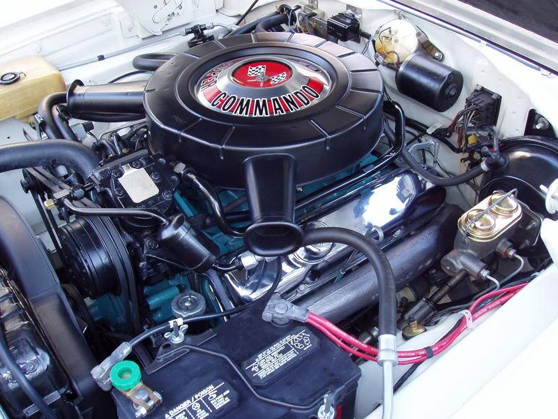

I have looked at many pictures of those air cleaners, and I have noticed the ones with vent tubes look like the top photo, and the ones that don't look like the bottom photo. If your car does not have a clean air package, I would think the bottom one is right.
Mine (67 GTX) seems to fit that pattern as it has no hose connection and matches the Commando one above

Mine originally was a non CAP car....currently has a CAP air cleaner on it now which matches the left 440 mag the OP posted

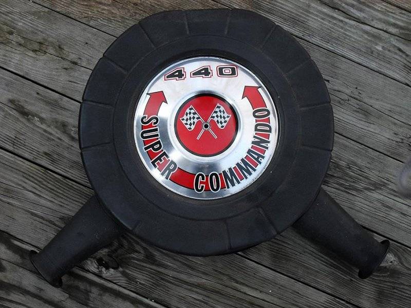

Got measurements and a photo of the baseplate on the air cleaner i was looking at. Top of the air cleaner is 4 inches tall and the baseplate looks like the taller version on nicksgarage air cleaner identification page. Looks to be for a 68 c body. Anyone know if it would work in a 67 Coronet R/T? I'll probably keep looking for the correct air cleaner but still be interesting to know if it would fit and still be able to close the hood since it's 5/8" taller.
Looks like this one from forcbodiesonly. 68 c body
I scored this one a while back ......... 3 3/8 tall, larger carb hole, 11 notches
The 67 440 mag had a 750 afb with the big hole
The 67 was the 13 notch lid.
so mine is a dual snork for a 68? ....... hell yeah

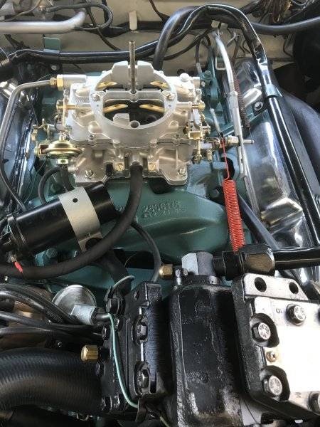

The 67 440 magnum AFB was a one year only carb. It had the big bolt pattern and the small airhorn.
The 4326 for manual trans and 4327 for the automatic. I just rebuilt my original 4327 for my R/T. A simple robust design that is tunable for whatever the stock 440 can handle.
Runs and drives better than the 800 cfm Edelbrock I had on my 67 GTX.
