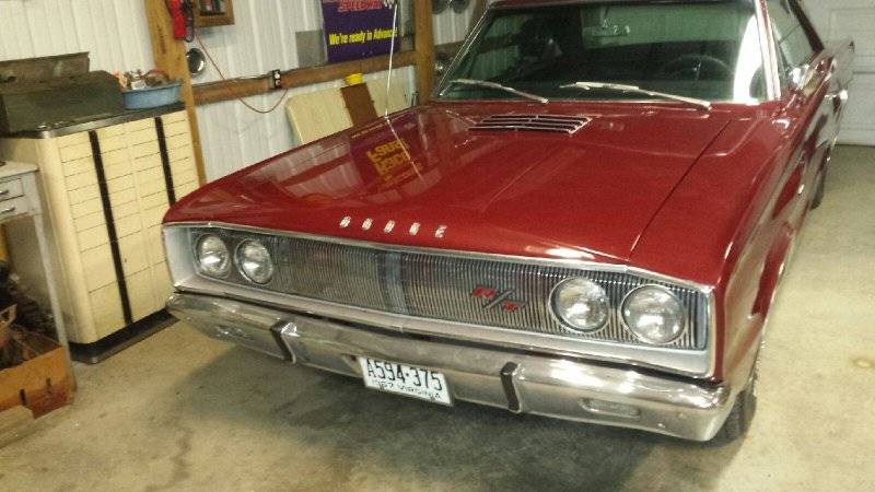

I've been playing around with tracking down a decent 1967 Coronet R/T for sale lately. I took a look at a 67 R/T that was for sale a few weeks back but it just had too many issues to justify the asking price and ended up being a no-go. Previous to that I was just looking for another not-obscenely-priced Mopar to add to the family, but since then I've sort of fallen for the 67 Coronet's and I've been looking to see what others I can find.

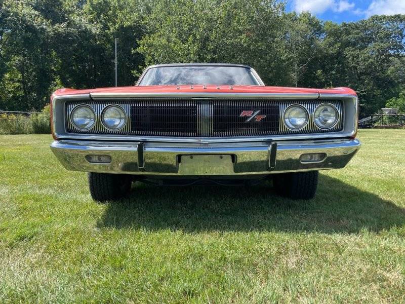

While looking I noticed what seems to be quite a few different cars out there with the black painted grill portions like the car pictured below. I know that the correct factory R/T grill should be all chrome with the blank center section, but I've noticed so many different real WS23L cars out there with the black grill sections it has me wondering if they might have actually left the factory this way. I've searched online and I can't seem to find a definite answer, only a few mentions of these being the same grill sections that would be fitted to a Coronet 500. Does anyone know anymore?

The grille painted like that is from a Coronet 500 only. It looks pretty silly on the R/T cars like that.
The grille is the part that the air passes through. The grille metal is the same on all coronets, with the black paint on the 500 only, then they bolt on the cross bars and a different center piece also.
To me the picture you posted isn't correct. I may be wrong but my 67 R/T when disassembled years ago the grill wasn't painted. The only black you saw was the blackout behind the grill. Maybe it had to do with exterior colors, I can't say for sure.
Might not be correct but i kind of like the center part blacked out like that. Cheapest part of the grill though so it's easy to get 2 and swap the correct one if you plan on selling.

photo from a factory advertisement. Notice the even color across entire front face.
I'm actually sort of impartial to the looks. I generally like my Mopar's the way they came from the factory, but I don't mind the look either.
I just wanted to see if it was actually a factory thing or not. Through various google searches and looking at cars online I'd say somewhere around 1/3 of the cars I've seen photos of have the blacked out grill sections. Whenever possible I've also looked for the signs of those cars R/T clones, such as still having 120 MPH speedometers, but pretty much all of them have been real R/T's.
Why do you see so many? Probably put the car together and got a grill from a 500 and removed the bars.
headlight bezel comparison. The 500 bezel has the black paint on the face, but not on the angled edges, giving the entire grill has a uniform look. Also a cut out and holes for extra trim so they can’t really go on any other model of Coronet than the 500.
The bottom bezel is for every other Coronet model other that the 500. The raised bars are left unpainted to match the center grille.
I tend to be a little obsessive compulsive when it comes to looking into these things and I like to research so I know what's original on a car and what's been changed. I've looked through a bunch of photos on older and current listings and it was just a somewhat common thing I noticed, like on this car, this car, or this car.
I do get it though that these cars are fast approaching 60 years old and the reproduction parts aren't available for them in the same way they are for later B bodies, so I can easily see a bunch of Coronet 500's sacrificing their grills to keep the R/T's going.
