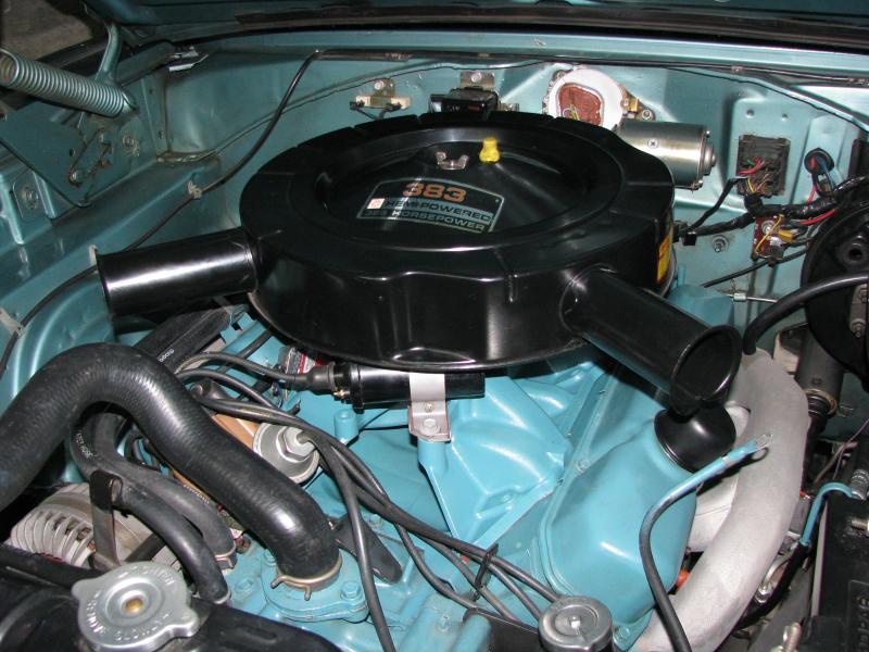

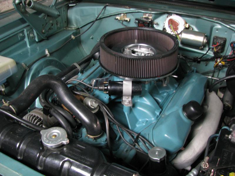

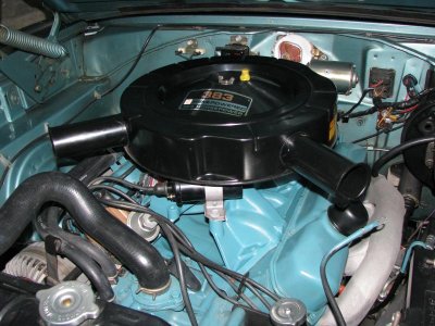

Is that a mock up picture before you got it running? I was so impressed with the stock look like I will go for I was zooming in to see what intake and I see no intake bolts lol
Yes i agree no intake bolts...
but this photo was taken during set up for air cleaner to hood clearance with Edelbrock Rpm intake manifold.
See the clay on top of air cleaner, I can have a good clearance with a drop air cleaner base ...
Im lovin it man! What a great idea for clearance but keep the factory looking dual snorkel!!!
