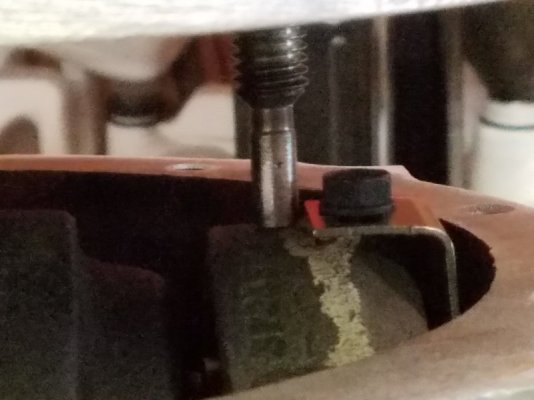

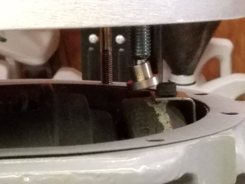

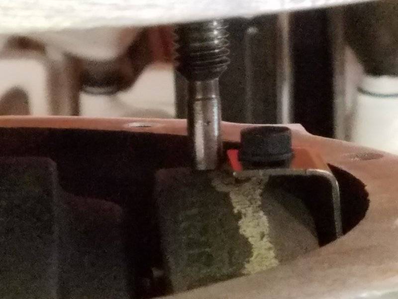

I modified mine to get rid of the
swivel feet so the screws make
direct contact with the bearing caps.
To this:
From this:
The girdle also helps to reinforce the
case, and finned to help cool the diff
fluid.
