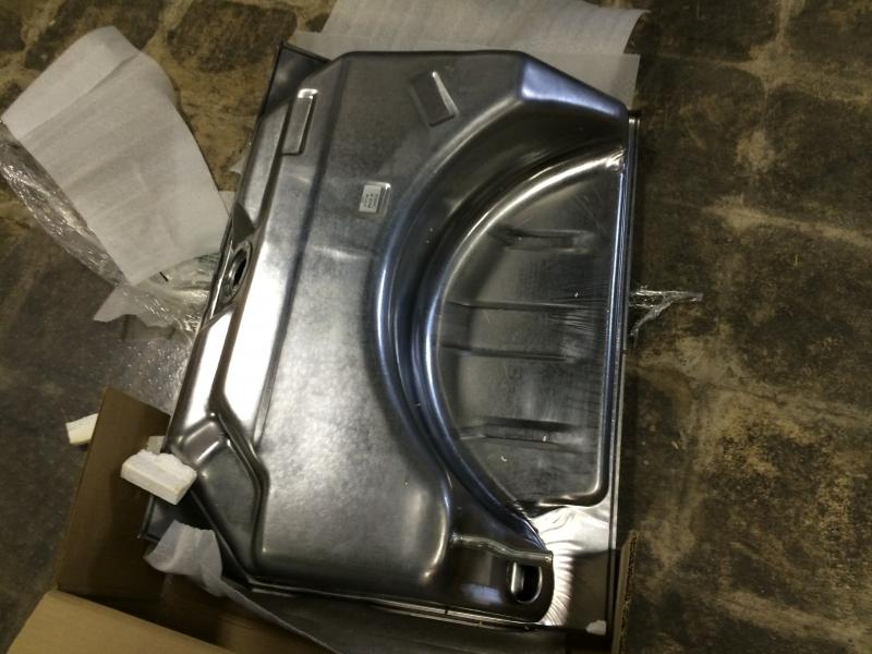

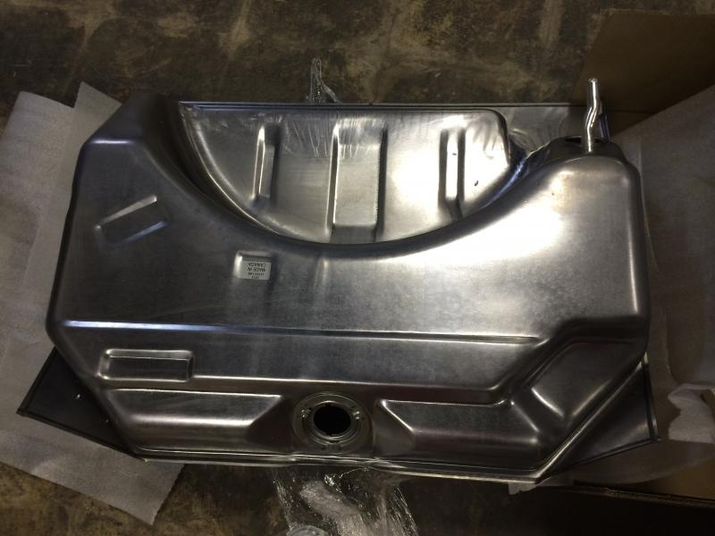

Pictures speak 000 words if you have them.
Here are pictures of my replacment tank. Notice the fill hole and the tube above it. This tube is the vent tube. The only other hole is for the sending unit.
My tank is identical, except it has a second vent tube on the upper right, same side as the sending unit, opposite the vent tube shown in the picture. Im calling it a vent tube only because I don't know what else it may be for. Perhaps I should label it a purge tube, etc. so not to confuse. My problem with the tank is that I have a leak, when full, and do not see any cracks or where it is leaking from. Thought the plugged up vent tube may be the problem. By the way where did you get your new tank and what's the price?
