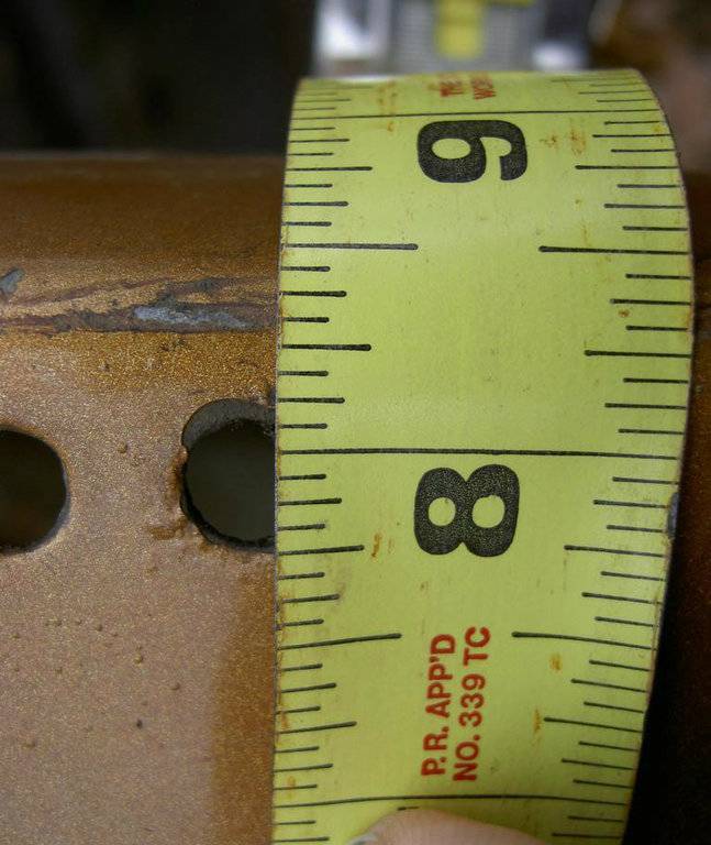

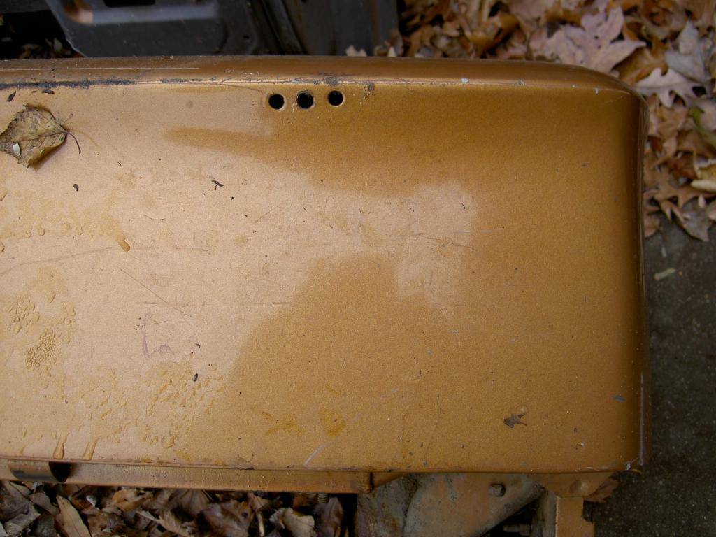

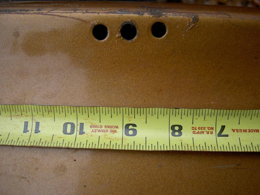

No template - but I do have a 67 Satellite fender. The signal has been removed and I shot some pics of the top. Hope these help.
Overview:
Measured by hooking tape edge on ridge at front of fender - headlight area:
Edge of fender up to first hole:

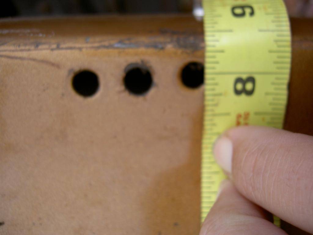

Edge of fender to center hole:
Thanks for the pics but I think they are in a different area on a Coronet. Some pictures I've seen they are more in the center of the fender down on the flat area.
