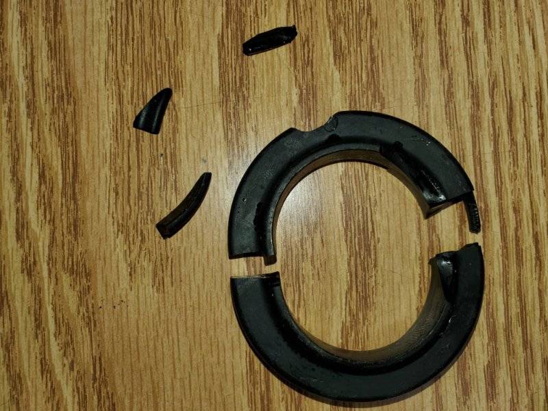

Check out the PIC's of my new Gas Cap Seals.

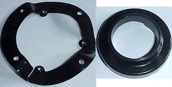

This is the seal behind the flip top gas cap, and just under the sheet metal bracket for the fill tube.
Going to be on my 3rd Gas Cap Seal now.
Bought one from 2 different places, and both cracked in half, disintegrated with pieces falling off after 2 weeks on the car.
Is anyone else having trouble with these seals cracking and pieces falling off?
Looks like the material used to make the current seals is hard plastic, not pliable / flexible rubber like my original one, and the new plastic seal is not petroleum or gas resistant.

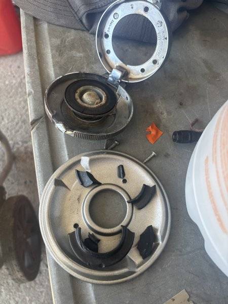

Yes, leaked bad when I was filling the tank, in between the cover and down the side of the quarter panel.
I looked at the seal and noticed it was cracked in half again, and little pieces stuck around the bracket.
2nd time this has happened to me.
Keep an eye on your seal, if it's like mine, they are not petroleum resistant.

The seal that's cracking is the large one under the flip top, mounts under the
sheet metal bracket and around the fill tube and the Bezel seals against it too.

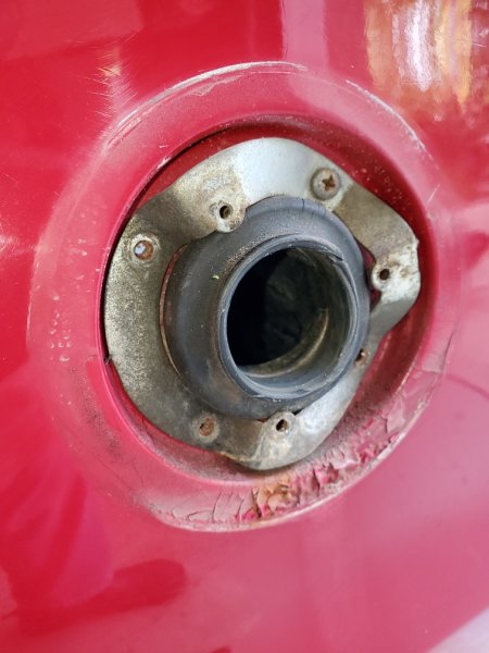

PIC is my old rubber seal that I want to replace, has hairline cracks, but it's rubber, not plastic.
