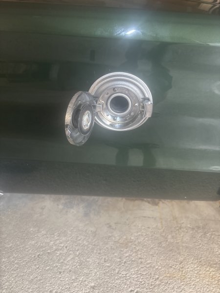

'67 GTX Flip Top Gas Cap Seal Problems

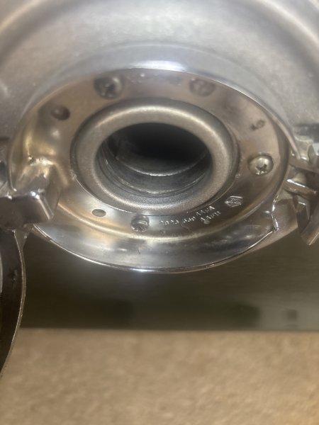

I’ve noticed the rubber seal on the setup I received from Mega Parts cracking as well. On one hand I’m thankful they even reproduce them, on the other why make a fuel system part that doesn’t tolerate fuel?
mega parts rubber seal crack also, now what.....going to install old seal.

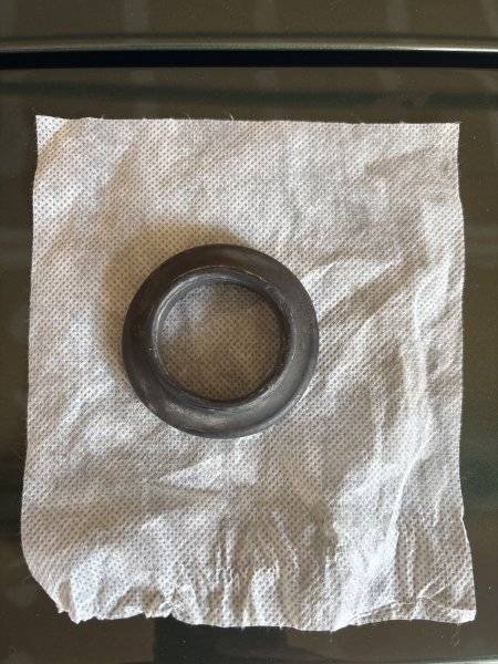

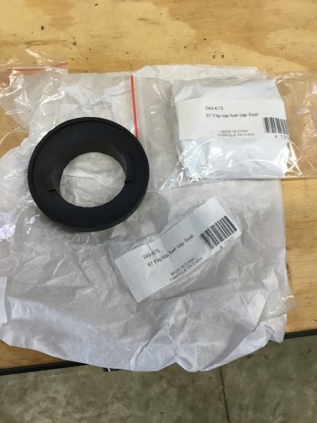

Received a couple of reproduction seals yesterday, I don’t have a lot of confidence . Thought about soaking one in gas overnight but maybe I’ll just consider this to be a two year supply
They're rubber correct? If so you could soften then with Ditzler vinyl conditioner or Lestoil cleaner. DON'T over do it if you try it, it will swell the rubber a lot if you leave it overnight or longer. If you have your old one try that first. Reason to try this is to make it more pliable so gasket will conform to the car body and ring. I'm worried that it could screw up your new part because it mentioned the material isn't gas resistant.

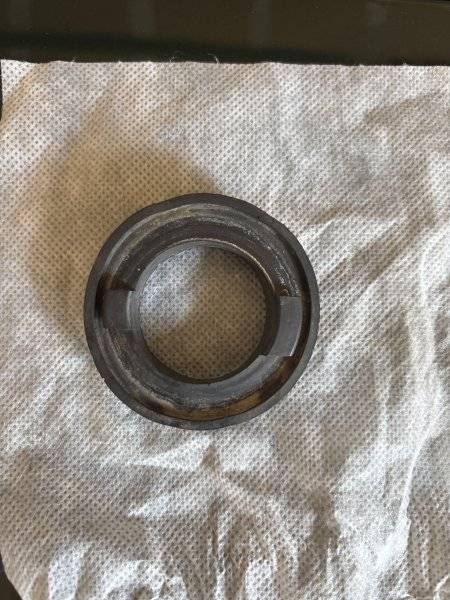

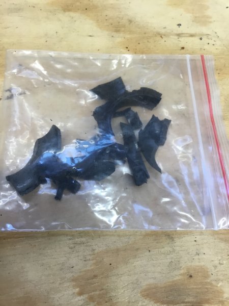

This is what’s left of my old reproduction seal after a couple years. And for the record never used gas containing alcohol
I’m really wishing I had hung on to my old seal after replacing it last year.
That's the dummest thing I've ever seen. Why the hell wouldn't Chrysler make a different filler neck that stuck out further and seal directly to the flip cap? That seal is a hack job at best, even factory. Amazes me how many will put up with things like this, but if done outside of factory, it's shunned. I can see ima hafta redesign the filler neck in order to delete this stupid seal.
