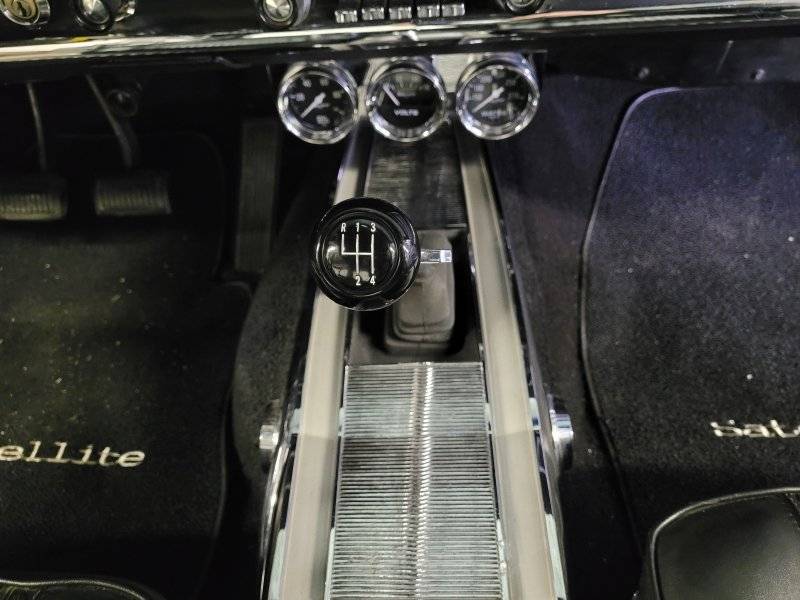

being a new '67 GTX owner, trying to learn some things: mist of the 4 speeds I've seen have a factory looking "reverse lock out" style shifter, while mine does not........did any come without, ir should I think mine has been changed out?
Yes yours has been changed from an inland to a Hurst.

Would have come with an inland shifter like stated above. They didn't have a great reputation from what i've read so lots of them got swapped for hurst.
If a gluten for originality there are inland shifter handles that can adapt to the hurst shifter unit. The lockout finger levers will be there - but non functional. My 66 came to me like this. I think I’ve seen them at Brewers Transmissions.

Brewer's has a very nice Hurst shifter mechanism that you can bolt an Inland shifter handle to.
It looks stock but has better shifting quality.

It looks like brewer's package is a rebuilt shifter mechanism and the Inland adapter bracket. I wonder if the used shifters are in short supply.
The little adapter bracket isn't real hard to fab up

I replaced my Inland shifter with a Hurst Super Competition, with a conversion kit to keep the shifter handle.
