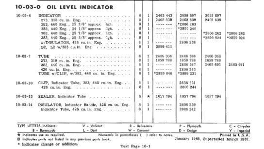

The 67 parts book shows two different length dip sticks for the b body w/ 440 engine. 25-3/8" and 24-1/8". Anyone know which is correct? Is one for AC car and one for non-AC?
The one currently in the car is only 22-5/8" from tip to the collar at the top.
The tube is the same with either stick. I would assume the High Performance took an extra quart.

I wonder why they show two different length sticks when only using one tube?
Good question. They all had the same pan. If the stick is different length the tube would need to be also.
Was the dipstick tube shaped differently to clear A/C lines?

I just looked again and there is another tube called tube with clip at the very bottom of the listing. Just no clarification as to what anything really fits. If a guy did not have a dipstick how would you know which one is right. Same for the tube. Only difference I can see is maybe the performance manifold required some extra special fit.
Looking at the catalog, the asterisk next to the part #'s indicates there is a "change or addition" Maybe it was this "clip" which was also available separately in group 10-3-10?

Not sure if the parts book measurement is total overall length including the hook? There could be variations in the hook's "hookedness"
