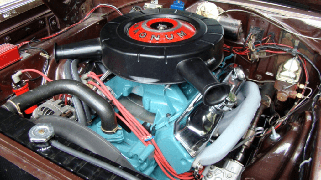

This isn't my car and it runs 11s this is how mine will look except I'll have headers and hidden ignition
Not my car just refernce
Looks good. I'll be doing the same with hidden ignition upgrades but with mainfolds...for now. Haha.
