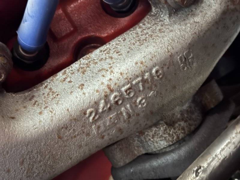

This is my driver side manifold casting # 2465719: IMG_7133.jpeg
This matches up to what TTI needs perfectly.

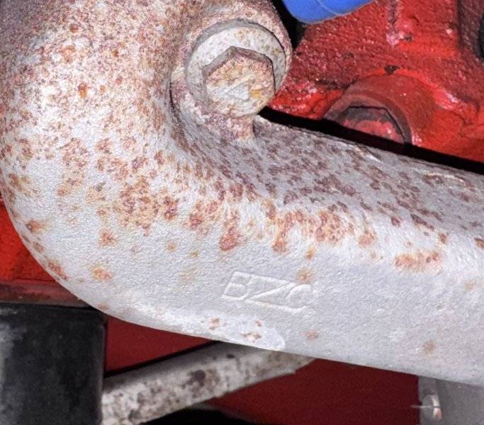

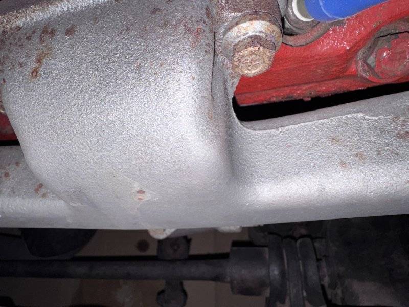

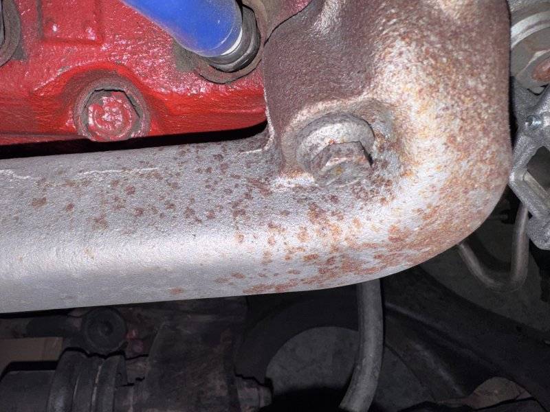

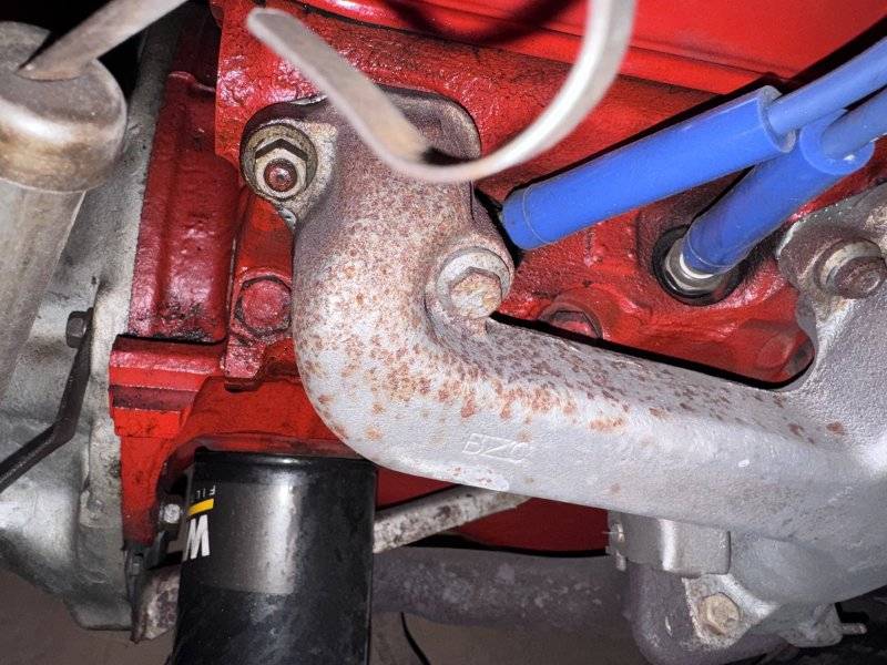

Now for the passenger side I have a bit of a mysteryIMG_7137.jpegIMG_7138.jpegIMG_7139.jpegIMG_7140.jpeg
This is the only marking I can see on the passenger manifold. "BZC"?
Any thoughts on what I have here?

This is my driver side manifold casting # 2465719:View attachment 1932955
Now for the passenger side I have a bit of a mysteryView attachment 1932965View attachment 1932968View attachment 1932971View attachment 1932974
Does it look like the head pipes are old? Possibly originals? Have they been added onto down by the transmission or the like. I am thinking that if the passenger's manifold was replaced, a new head pipe could have been made to fit the system. If the pipe from the manifold back is one piece, the manifold is probably the stock one. #2843953

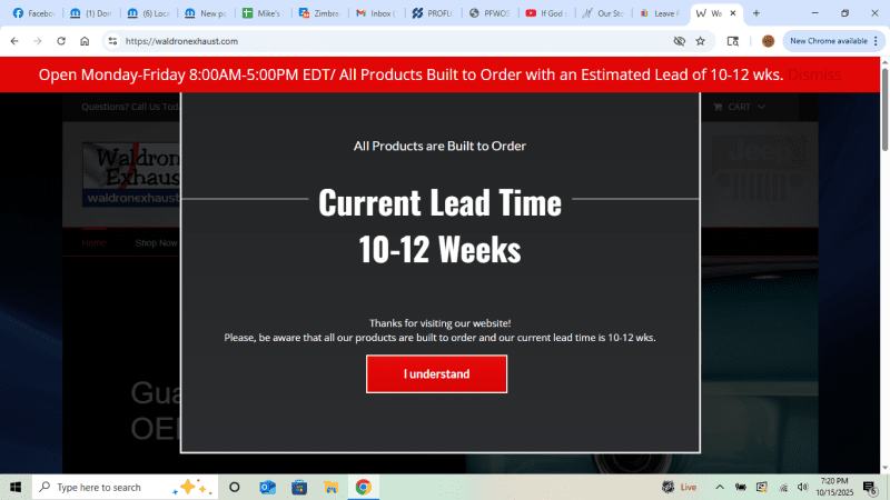

Waldrons is another option. I see they are 10-12 weeks out though.
