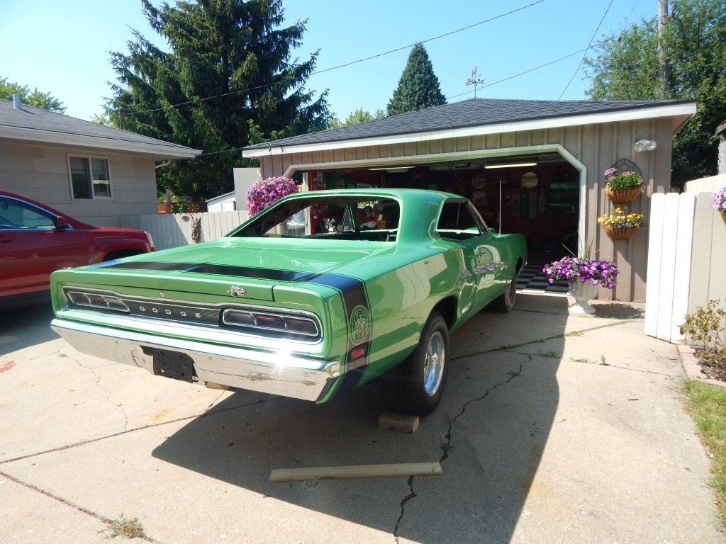

Thank You for your responce, great looking ride! I can't wait till I get mine back together again, it's been a LONG time.

I have to get the exhaust , fuel pump , alternator, engine wiring in and dash and then I will be able to get it started. Then comes the Interior , vinyl top and side scoops , so I have a long way to go. Would like to be done by spring.
