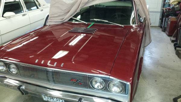

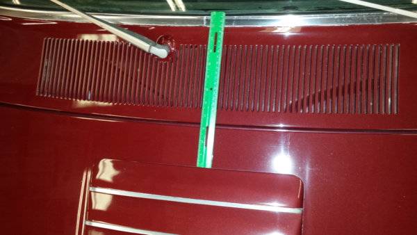

Need info on how far back from cowl edge of hood to mount factory scoop on 67 Coronet R/T if someone could do a measurment from edge of hood to scoop would be very helpful and a pic from above would be great thanks guys.
Provided you're talking about the factory Super Stock Scoop then Flush with the back of the hood. This has been discussed many times but was proven that on a factory WO car it is flush. Mine, on the other hand, was installed an inch forward but that was before I knew any better.
Here we go, hope this helps. It is 3" from rear of hood to back of scoop...
