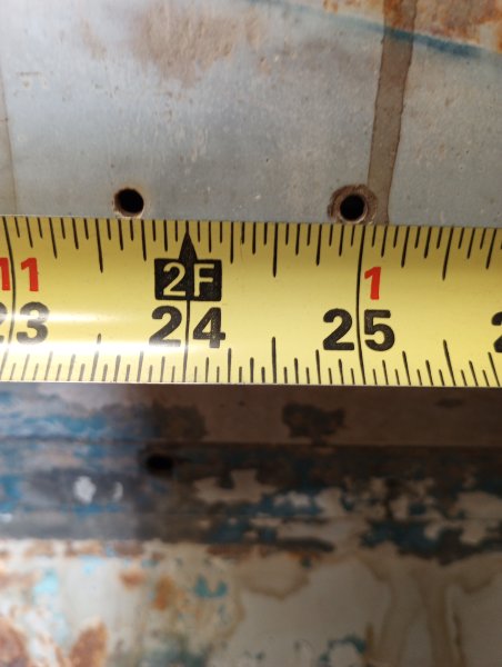

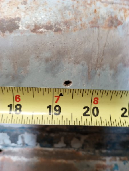

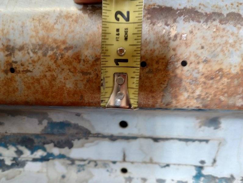

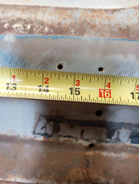

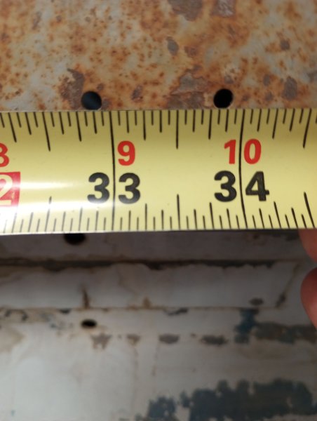

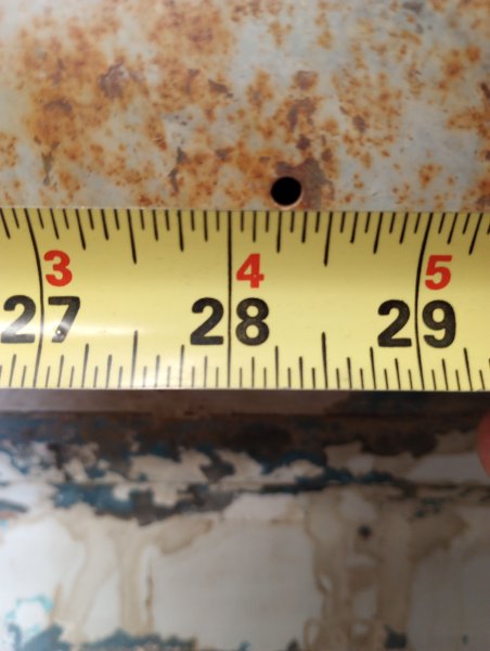

Took these photos of my 67 r/t trunk measured from the driver side edge of trunk lid. First hole for the "letter D" is about 14.5" from the driver side edge of the lid. I can't be sure this is an original trunk but seems to be. You might want to verify measurements with other r/t owners.
D
O
D
G
E
Vertical measurement from trunk body line up to holes.

Probably best to verify with someone else on the hole measurements. Now that i look, there's only one hole for the "o" and "g" letters on my trunk. Seems there should be two holes for each letter from pics i've seen online.
