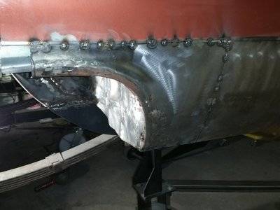

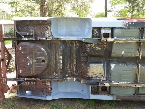

If you're planning on doing the work to open up the wheel wells, you might as well take them all the way to frame rail and eliminate any concerns that you didn't go far enough. Plus, the frame rails are a great place to reattach the wells and get you a very solid result. The end result will look like this . . .

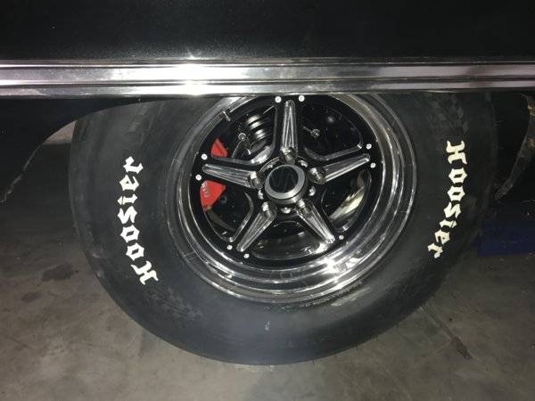

Yes, you’ll never fit a 315 in a factory 67 coronet well, I have 275’s on mine and there’s no room for anymore tire

How much trouble is it to get the 275 off and on the car with stock opening? Has to be tight.

I opened mine up . . . on the front of the wheel well, I move the lip to the inside well . . .
Like this . . .
But I don't have my tires in the opening to tell you how much it'll help . . . yet . . .

Ya I had to wrestle them for a while, unbolt shocks and deflate the tires wrestle it for a good 20 minutes

It’s worth the fight, it was easier when I had the leaf spring set up, seemed harder with the 4 link now. Either way it’s worth the time IMO
In the process of mini-tubbing a '69 RR. The issue I have going flush to the frame rail is that frame lip gives the rail rigidity. Cut the lip off and all you left with is a thin flat side that's now prone to flexing.
Regardless of what you do, keep in mind the frame narrows front to back. If you go right to the rail your filler strip will need to be pieced in and the rear will be wider than the front.

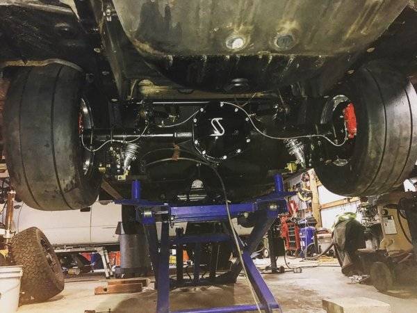

I did a spring relocation and mini-tub job on my 67 coronet 500. Had I thought of it, I would have lengthened my wheelbase and moved the rear axle back 1 inch. The stock axle location is biased towards the front of the opening and the extra inch would have allowed me to easily run a 30 inch tire. As it is, a 29” inch would be very close. You’re still going to have to deflate the tire and possibly unbolt some hardware to wrestle them into the wheel well. That part is worth the effort. I’m running an N50–15 and the wide tire completely changes the attitude of the car.
