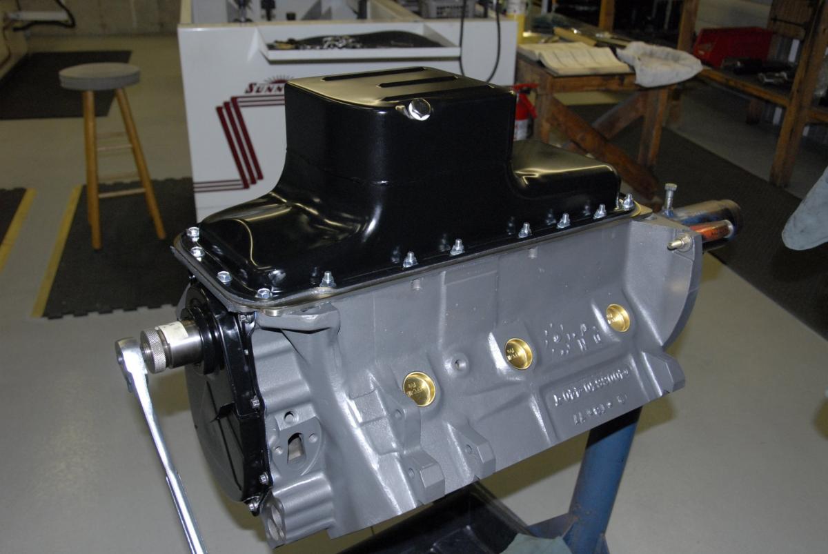

Thanks again for everyone's input. That is a beautiful car. Thus far my efforts to port photos have proved futile, but here I go again....Marks_493_small_(1).jpg
Nice images1

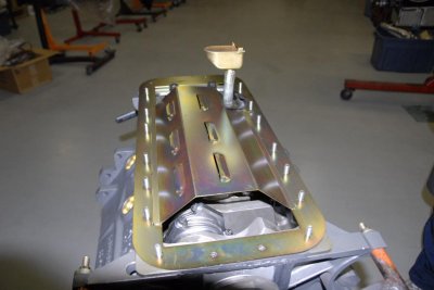

With that type windage tray I've taken a screwdriver and opened up those louvers a little more from better oil flow {return} to the pan. :sSig_goodjob:
That is one clean shop!

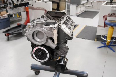

The engine looks great so far. Is that gray paint or some kind of primer on the block?
Yes, you can pretty much eat off of this floor. The builder's name is Steve Flatt in Lindon Utah. His most competitive customer is Ed Olpin who competes in Super Comp. I think he went to the finals at the winter nationals this year, and lost a fuel pump. He also built the Hemi in the 34 Ford that made it into the final eight of the riddler competition in Detroit last week. I would share the horsepower on the Hemi, but most would call BS....let's just say it made some big ponies! He does great work, but you get what you pay for, and he aint cheap! I did just go with the gray paint. I've had my share of orange motors, so I decided to go a different route on this one. We bolted the heads on yesterday, all that is left is the final port work on the intake. Should go to the dyno in a few weeks...
