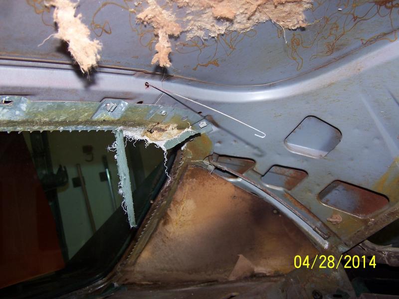

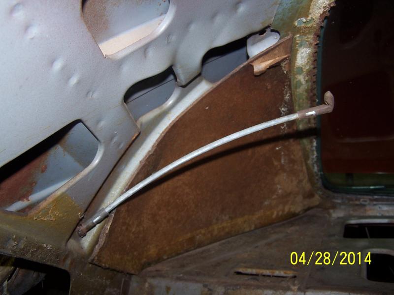

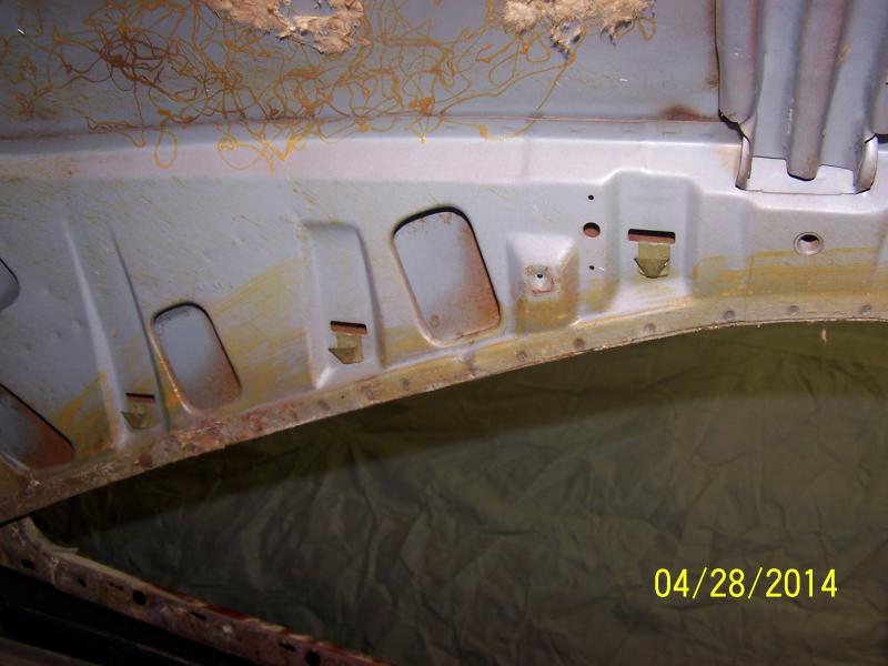

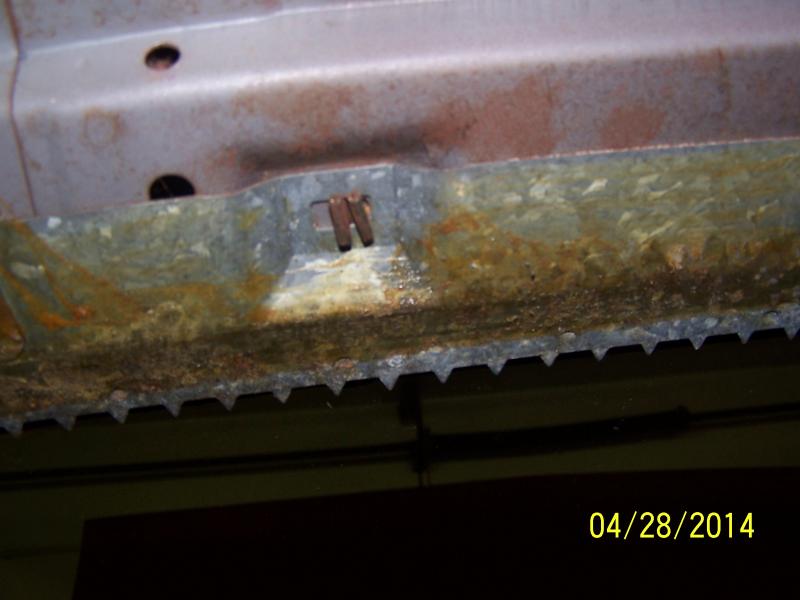

just wondering how the sail panels install on a 68 charger, Do i just screw them in at the top and glue them in at the bottom? How does the headliner attach to the panels.. Thanks
Here are some pics of the sail panels in my 68 Charger. I just removed the old headliner the other day and took some photos. The sail panels did not seem to be glued in at all. Only one nail holding them on. I plan on pulling the nail out and using a screw when it goes back together. the headliner does not attach to the sail panels. Hope this helps. 100_6273.jpg100_6274.jpg100_6275.jpg100_6276.jpg
