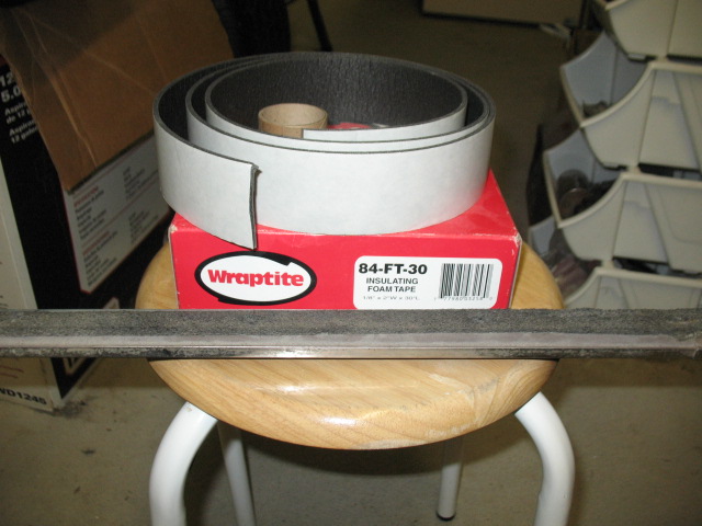

Heres what I used on my 68 Bee.I,m a HVAC service tech and used 1/8" foam tape trimed to fit
