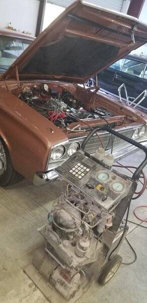

All I have to say is really hearsay, but if true I wouldn't let Classic Auto Air touch a car of mine. I bought a car that supposedly had the air done there. I was told that they told him that everything was good except the control head. His words not mine. So he was told get a replacement for that and everything will work.
What I found:
No O-rings on any fittings, no charged system, some rewiring that burnt up the vaccum switch, the condenser with blockage, the dryer was trash, rerouting of vacuum lines making the actuators fight each other, and the blower switch resistor bad. A new style compressor was installed, but the worst looking job I have seen. The good was the water valve was as new, not adjusted right but good.
I have bought a complete system from these people that I installed and have nothing bad to say about their systems, but if the above system was done there, no thanks.

I'm not sure that I can recommend someone, as I ended up chasing everything myself, with the help of a friend. Also I noted that I'm not sure of the truth. The guy was trying to sell a car, and did. The A/C was a deciding factor that didn't turn out so good for me, but it is done and working.
