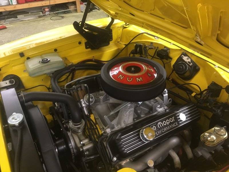

Ok, I found some brake fluid on the back side of the master cylinder by the area where the booster rod goes into the back of it late last night I forgot to mention. Is there any check valves inside the master that could be sticking/leaking causing the brakes to hold on for a period of time? Also......Master looks to be a equal reservoir on both front and rear which is usually a drum/drum master correct? I think I may put a new disc master cylinder on it before going anywhere else because its leaking anyway and I want to be sure a disc/drum master is on the car before chasing any other direction.
See below the photo.....master cylinder looks like equal reservoirs to me and drum type I know is usually like this.

just some springs and O-rings , they are on plungers . the main purpose is to prevent nosedive from the front discs applying too soon. some times you will get crap inside them that will cause issues, but I would start with the correct master cylinder and move to the proportioning valve. if it's leaking out of the back of the M/C , I could almost guarantee it's sucking air as well

It was that ******* master cylinder! I just swapped it tonight and now the car rolls farther and freer than ever. The brakes kind of suck after bleedin, but I think the front pads are glazed from hanging that whole time and getting super hot. I think I’m going to slam a new set of front pads on it in the next couple weeks but it’s way better already. I have a really hard pedal just doesn’t grab much, but like I said I think the pads are fried from getting so hot. Thanks again for all the advice everybody! Another mystery solved.
