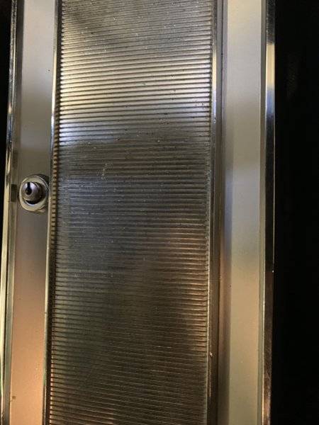

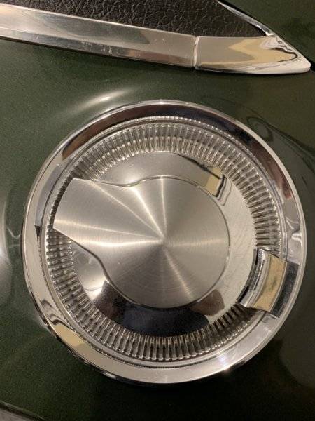

Good Day,
I know on the ‘69 gas cap the recesses are blacked out. What about the 68?.......i see most without like the picture below.
Also....the lines in the console...do they go blacked out in the recess as well?
Please share your methods if you have any!
Thanks

I'm not sure about the 68 gas cap, but on the console top plates the recesses are blacked out. Use satin black not gloss.

I wouldn't use mineral spirts, it doesn't flash off quickly so it would seep down into the grooves and cause the paint to lift.....
I'd use lacquer thinner or acetone.... Stretch the rag tight over a flat block, it may take repeated passes but at least you'll only clean the top surfaces & not effect the paint down in the grooves...
I have sprayed the entire ribbed portion satin black and let dry for a week and then used 0000 steel wool on it with good results.

No paint in the recesses in 68 fuel cap ring or console. Only the cap itself in 69 was painted black in the recessed area. I would think if you paint it, you probably better not spill any gasoline on it.

I agree I don't ever remember seeing a 68 console lid with black in the grooves. I rode a lot of miles in my cousins 68 R/T when it was new. Don't remember any black on it. A silver a long the outer edges and chrome every were else.
I don’t recall the console door having “black out”....
Ok. Now we are getting somewhere. No black out like the 69 gas cap....and also not in the console grooves is what I am getting here. That is why I guess “most” of the 68 caps i see do not have it.
