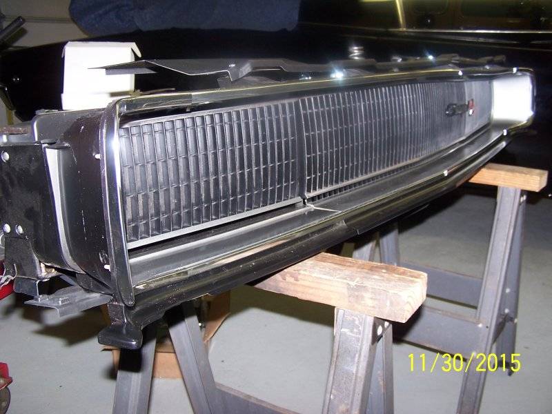

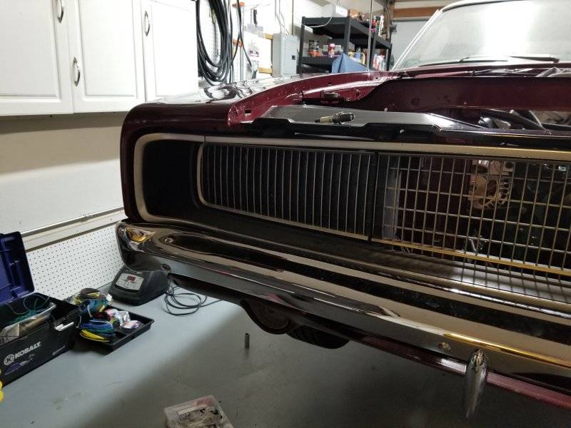

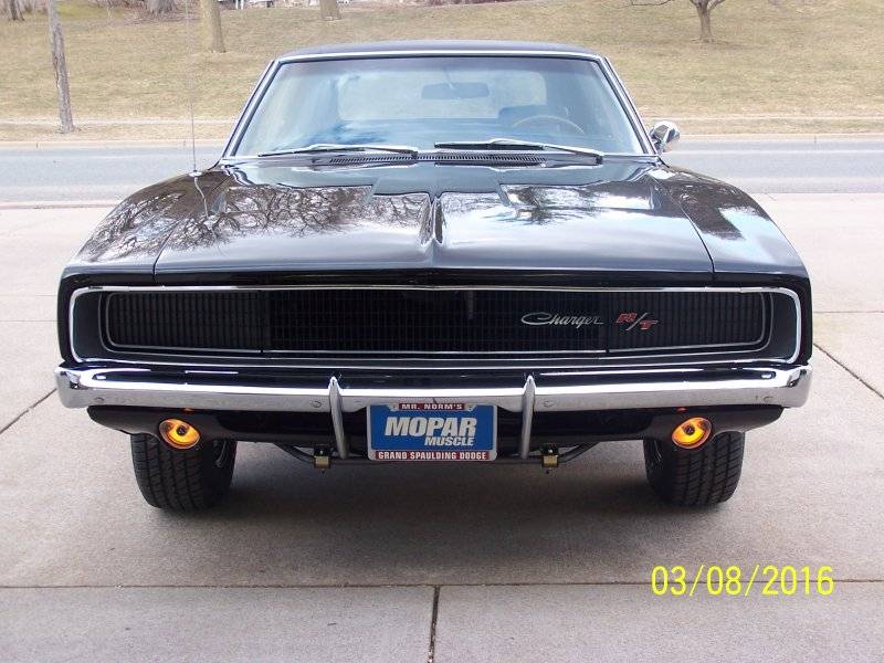

I did the work on this grill I think in about 2000 or 2001. I started with a POS. Put a lot of hours into this. Had to replace/repair a lot of the plastic.I painted the fins first with Dutch Boy dull aluminum. I thought it was silver but it wasn't. I got the paint codes from someone on Moparts. It may not be a perfect match but it looks good. After the fronts of the fins were painted I used thin painters tape and masked each fin. Then I painted the rest of the grill in satin black. It looks more correct when everything is put together. Just installed a 512 and getting ready for operational checks.
