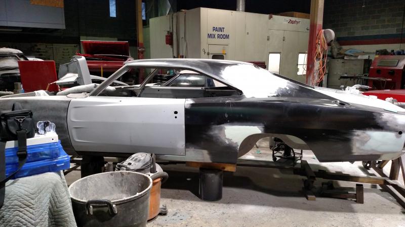

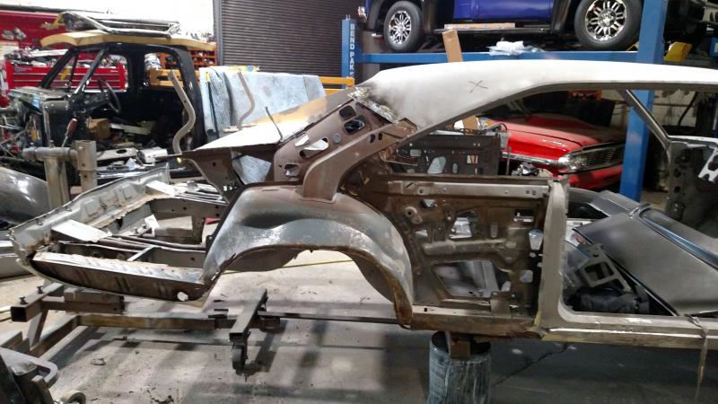

Members, I started my 68 Charger restoration over a year ago. As a junior - junior member, I started the process with a pre-elementary school knowledge base. It is amazing how fast you learn when you start purchasing parts for the car. I have been filming the entire restoration and hope to produce a mini film when the car is completed. I am thinking about naming the film: Restoration of a Dodge Charger - Failing Forward. Regardless, I want to you guys for answer my questions and assistance with parts. I am attaching a few photos. As you can tell, the car is still a work in progress. Scott

I am attempting to restore the car to factory (well as much as much wallet will allow). The good news is the 440 HP, 727 trans and 8 3/4 rear are matching. The original color is LL1 (Turquoise). The car is pretty cool in the fact that it has power windows and power brakes. Trying to find parts for the rear quarter windows has been an adventure. I am now down to finding specific bolts. I had no idea that the 68 Charger had so many different bolts. When we took the car apart we found that almost 70% of the bolts, studs and nuts were incorrect. Sorry for rambling - I really appreciate the feedback. I hope to finish the car and bring it Carlisle this summer. Thanks again, Scott

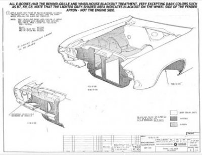

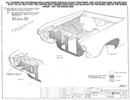

Members, the car just went into the booth for epoxy primer. Please correct me if I am wrong - the dash and steering column is painted with a suede black color. I believe Mike Mancini at instrument specialties carries the paint (DDL 9324). The rear panel and grille/core support is painted with organisol. I believe that Roger Gibson sells the organisol paint (DCC 9355(. If so, how much will I need? One pint? Two pints? Finally, the windshield frame and A pillar blackout. It is my understanding that the blackout is brushed on. What is the blackout paint? Suede? Organisol? Other? I really appreciate the feedback. Scott
