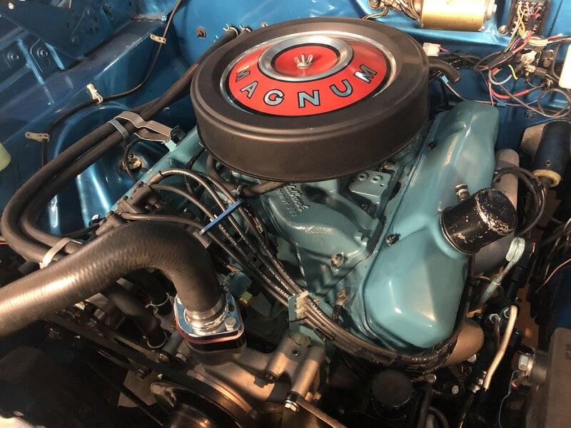

'68 Coronet project EFI/4 speed conversion up and running!
Well, all this PCV talk got the wheels turning - have to think this old guy is not doing much of anything except creating a vacuum leak. Have not gotten around to finding a f.o. type yet.
The main reason the PCV was out was to pop the valve covers off and see what, if anything was to be seen in regards to my leaks. They're not as bad as I thought but I can see where they were wicking oil in the lower corners. The lower corner bolt threads were soaked with oil so it's weeping past the gasket. These cork gaskets were free and filled in OK but clearly are not up to the task. Plus, now that they're off they're pretty much junk. Have some new gaskets on the way from Summit, ordered two different brands just in case.
Never gave it much thought before but now that I am dealing with these leaks head on, it's obvious why people have been pulling their hair out with this nonsense for 50 years.
You aren't going to get those valve covers to seal up with those gaskets. That is stone age technology that you're dealing with.
Back with some more updates. More like two steps forward, three steps back.

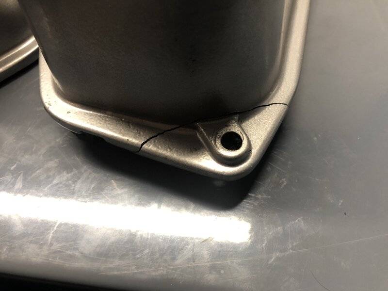

Had this really crummy thing happen to me for the second time - I cracked a valve cover. I'm really upset about this one, these are made-in-Japan M/T no logo covers which are super rare and in really nice shape. At some point I may take it somewhere to see if it can be repaired. Same thing happened with a set of Cal Custom covers.
So painful and expensive lesson learned - don't use cast valve covers on OE heads with "modern" gaskets. I should have known better and could have avoided this but obviously was not thinking clearly. When I installed them, I could see a gap between the head and the gasket which obviously would have leaked oil everywhere. Kept going around and tightening the bolts a little at a time with a 1/4" ratchet to see if it would close down but no dice. Guess I found the breaking point. I'm sick over this, just totally pissed at myself.
Luckily I ordered two sets of gaskets from Summit. I used Fel-Pro 1612 on the cast ones here but also got a set of Mr. Gasket Ultra-Seal "just in case". Glad I had the foresight to do that because luckily I had a pair of OE stamped-steel valve covers on the shelf. Cleaned them up, sprayed a little paint and they were ready to go.
Incidentally, I used valve cover studs with these which worked out well. They are ARP made specifically for use with OE type stamped valve covers. I bought them mistakenly several years ago but never used them because I usually use some type of cast covers.
I also went against my better judgement and used a ton of gasket goop to glue the gaskets down. Definitely fought with it, was oozing out everywhere but in the end, it worked. Took the car out for an extended drive the other day and no visible leaks for now.

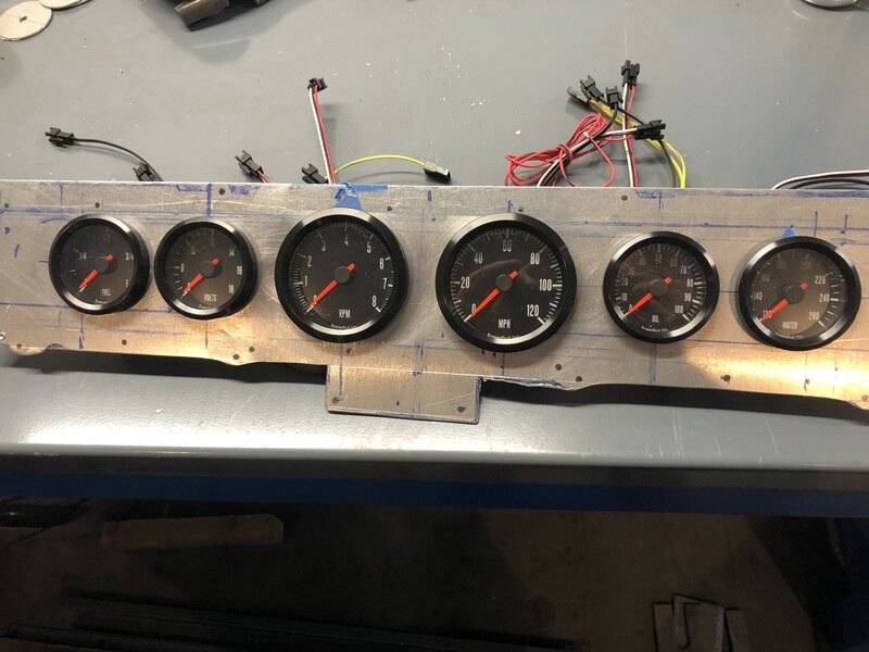

But on to the car. Back in November I ordered a full set of Speedhut gauges to replace the disappointing Holley EFI gauges. The SH gauges were on sale for the holidays so I went ahead and ordered a custom set and got a decent deal. The nice thing with them is that they allow customers to design their own gauge faces and layouts so I took advantage of that and had them configured the way I wanted them. Couple rounds of proofs with the art department and I now have gauges I designed myself. Nothing fancy, modeled after Autometer Traditional Chrome without the shiny bezels which I thought would be distracting.
The main issue at hand with installing custom gauges in a standard '68-'70 dash is the height of the instrument panel. I wound up using 2 5/8" housings for the speedo and tach which are relatively small compared to your typical 3 3/8" gauges. A big drawback to having a 2 5/8" speedometer is there is no odometer but as long as I have a working gas gauge it won't matter too much.
So because of the short panel height, most off-the-shelf gauges really won't fit without major surgery. The solution was to make a custom panel out of aluminum. I used the standard dash blackout overlay as a template for the shape so it basically bolts in the same way the factory part does. The back of the cluster is gutted now just leaving the housing so the panel has something to attach to. The panel needs to have turn signals and a brights indicator installed. On the fence if I want to install a low oil pressure warning light and/or keep the low brake pressure indicator. Then its paint and wiring and back into the car.

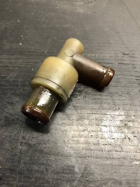

Second new item is a fancy M/E Wagner "Dual Flow" adjustable PCV valve. There was recently a group buy on these on Moparts that I managed to get in on so the price was almost $30 less. There is a bunch of info out there regarding EFI and PCV valves and how the 50-year old non-adjustable ones can wreak havoc with your EFI A/F inputs.
So the basic solution is to get one of these fancy valves and run it in closed orifice mode. Seems like a bit of a waste to spend so much coin on one of these things only to use it this sort of simplified manner but rather than trying to engineer something it appears to be a reasonable solution. Not sure what I will be looking for as far as drivability. The ECU is self-learning so if you've had a vacuum leak since day one, your fuel tables will have adjusted to those conditions. Suppose I will have to to remember to save a file before installing the valve to be able to compare A to B.

Speaking of oil leaks, the new Wagner PCV valve is in. Before I put the valve in, I made a few small changes to the EFI idle settings. Checked the manifold vacuum, was around 14-15" at idle. In gear it dropped like normal but I don't remember to what. While checking the vacuum, I noticed the idle was pretty rich because I could smell it and my eyes were burning. Went online and read up on idle tuning and learned that the default idle "target" AFR is 12:1 = rich. I changed that parameter to 14.2:1 which certainly cleaned it up. Not quite stoich (14.7:1) but not 12:1! Vacuum did not change really but at least my eyes were no longer burning. Kept the idle timing the same. I did try bumping it a few degrees to see what would happen but the vacuum didn't really change. I might try to increase the idle timing again but I left it at 17 for the time being, one thing at a time.
But back to the PCV valve. Honestly, I'm not noticing any real change in drivability with the PCV though I'm not sure there would be noticeable changes in performance. The valve is in "fixed orifice" mode so it does not work based on engine load. I have not looked into the data tables to see if there is any drastic change but I'm guessing there isn't anything to write home about. I really need to get a working PC for on the fly tuning. Tried fixing up an older one I have but it won't hold a charge. May try to find a cheap one just for having in the car.

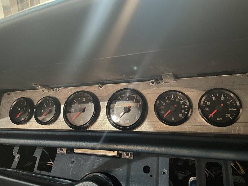

Just adding a little update on my thread here. Got back on the gauge panel and mocked it up in the car. It's not perfect but it's decent enough and fits nicely. Took a lot of whittling with a file to get it to sit snugly inside the OE bezel housing. The bottom of the gauge bezels are a little too low. Not sure if I'm going to leave it alone or try to adjust it so they look more centered top to bottom but there's not a lot of room anyway with the dash trim installed. Panel has to be wired, indicators installed and then paint. It should look OK when it's painted.
That's all for tonight!

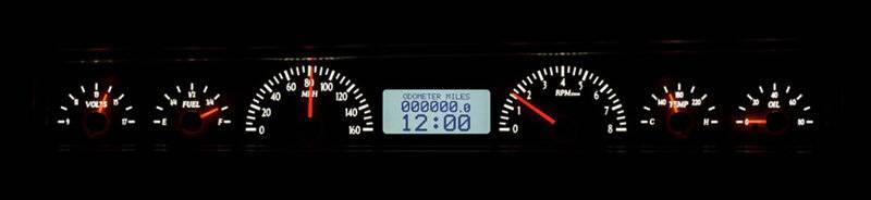

Yeah, I’ve seen those, they’ve been around for a while now. I just can’t stand the way they look. You’d think there would have been more effort towards making them “look the part”. Its mostly the odometer and clock, they look so generic and out of place.
Plus, they are about a grand. My Speedhut gauges were $625 and I designed the faces myself.

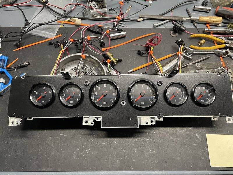

Little more progress on the instrument panel today. The face of it is done. Turn signal and brights indicators installed, obviously painted. Wiring is going to be a PITA. The previous Holley gauges had a lot of wires extending all over the place. I have a problem leaving unused wires just hanging or even just tucked into the rest of the harness. Was looking at it today, I know there's the potential for me to take the entire harness apart again just to get at the unused wires. We'll see how nuts I get with all that. That's all for now.
I agree, it's like putting a 1991 f150 gauge set in there!
I don't know how much "better" my setup is but it's definitely less generic. I opted for modern-looking black bezels instead of brushed aluminum to cut down on glare. Not sure if that's going to matter since the gauges are under the dash overhang but the less distractions the better.

Continued working on the gauges today. Got the wiring done to the point of having power and lights. Did a quick connectivity test to make sure all the lights work, see below. I really like the way these look lit up, will be a huge improvement in visibility over the OE cluster.
Have to run the coolant temp sender and oil pressure wires through the firewall to their respective connections in the engine bay and figure out the tach sender wire. The Holley Sniper ECU has a tach output provision which I was using already with an Autometer tach I just have to figure out where I ran it under the dash.

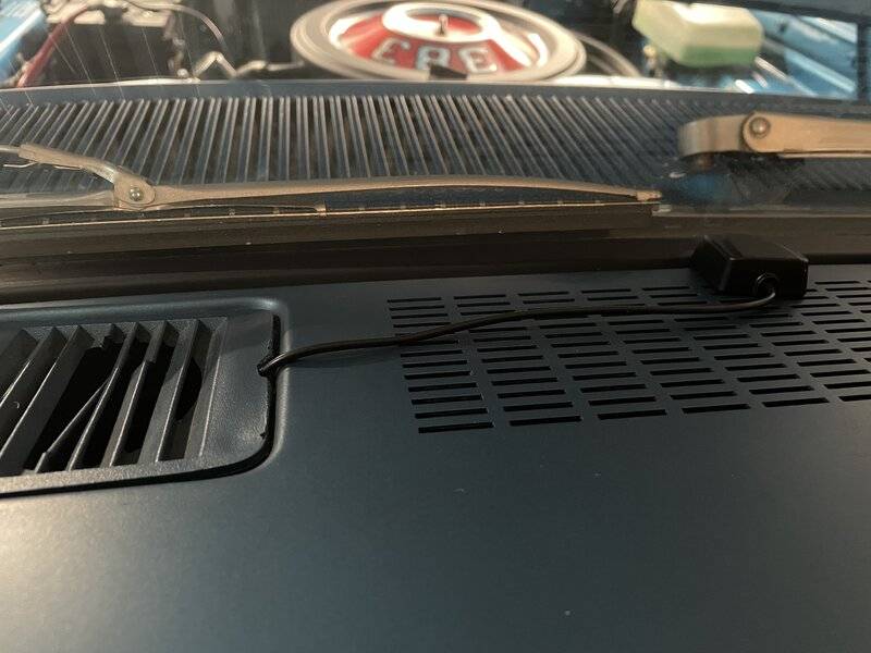

Dealt with the GPS speedometer cable today as well. I figured out a way to mount it on the dash and have it be a little less conspicuous. It needs to be facing up and must be unobstructed so it picks up a satellite signal. The instructions say you can actually put it on the roof but no way I'm doing that.
Anyway, the little GPS signal pickup module has a magnetic backing so it sticks to the dash surface. It has a long coaxial type wire running off it that routes to the speedometer itself. Didn't want to drill any extra holes in my dash so I ran it under the defroster vent. Had to file the edge of it down so it dosen't chafe the wire but the vent was broken already so I didn't feel so bad about it. Worked good. Just have to order a block off plug for the trans now and bye bye noisy and cumbersome speedo cable.

check your oil pressure sending port on top of engine. mine backed out just enough to flow oil only when driven then would clear up when parked. after tightening my oil leak when away n things are bone dry.
great looking gauges. nice work!
watermelon
Thanks! I do like these gauges. I wish the panel had a little more style but at least it's functional.
