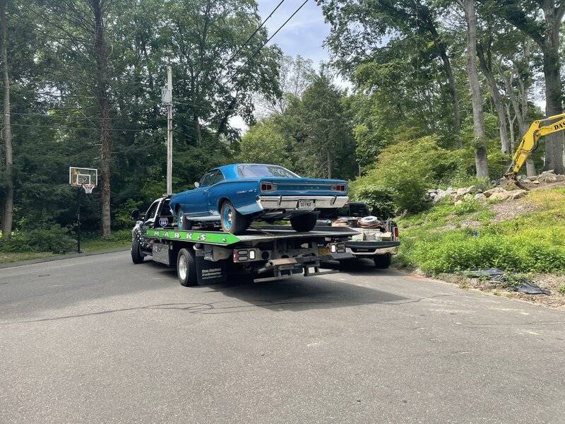

I'll start by saying that today was a crappy day for me and this car, had to get towed home about 30 minutes away from my house. Turned out to be a bad ground wire from the ignition box but it took me all afternoon to figure it out, not to mention an entire day of missed work and a lot of aggravation.
Was fairly nice around here, not too hot, overcast and less humidity than normal so I decided to take the Coronet in to work. I had been driving it a lot recently without any real issues and do try to take it out when ever it makes sense. Get in, turn the key and head down the road.
About 25 minutes into the ride I was coasting down a hill after getting off the highway and the car just shut off like it ran out of fuel. I installed a new gas gauge recently but I wasn't sure it was reading right. After rolling to a stop, I hopped out, took the tank cap off and shook the car hoping hear gas sloshing around - check. I even shone my phone light down there to verify and I could definitely see some gas in there - double check.
I've had some stalling issues before but the car would always restart after sitting for a little bit. Not this time! I fiddled with some Sniper parameters to see if I could effect some change but nothing clicked. All the fuess were good. Maybe it was a heat soak issue? The throttle body was really hot so I let it sit for a while hoping that if it cooled off it would fire. 30 minutes later, still no dice.
Eventually a cop pulled up behind me. He came over to me and I explained what I thought was going on. He was cool and let me keep trying to get it started. He waited there for a long time but after about 45 minutes he said I need to get a move on being on a busy road and all. At that point I had been trying to get it started for almost two hours. With no glimmer of hope I knew I had to throw in the towel and call AAA. Luckily I have a Plus membership which gets you 100 miles free towing. Besides a being an already frustrating day it would have been an expensive one too without that.
Tow truck comes fairly quickly for once and gets me home no problem, even enjoyed talking with the driver. Unfortunately our driveway has an unusually steep grade off the street and the flatbed was dragging the rear frame to the point of bridging the drive wheels. He made several attempts to get up the driveway both forward and backward with no luck. We tried using boards under the wheels to raise the rear up but even then it was still an exercise in futility. Understandably not wanting to get stuck loaded up with a car on his flatbed, he dropped it off in the street across from my house. At this point I'm really scratching my head wondering how I'm going to Macgyver this one and get the car in the garage.

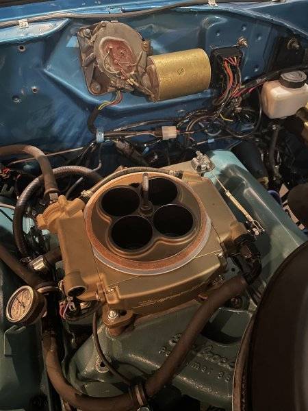

Time for an update on the car here. Been driving it a bunch lately and it's actually been pretty good. Since coming home on the hook last month it's been back out on several longer round trips of at least 30-40 miles one way and has not skipped a beat. Even seems like the mileage has improved.
First of all, I'm going to give myself a little pat on the back and say the EFI is pretty well dialed in right now. "Building" a tune in the software was a turning point in this process for me. It was a good learning experience and illuminated several things that initially were not very clear to me when I first started messing with this system. In all honesty I wouldn't have been able to get to where I am now without diving in to the software tables.
Unfortunately, I think there are plenty of people out there who believe the "plug and play" advertising line which is misleading because users really need take an active role in it. For me it was well worth the time and effort of building custom timing and fuel tables for my specific application because this car runs better, smoother and quieter than it has since I've owned it. Acceleration is good from a stop or from a roll. No random shutting off and getting stuck on the side of the road 30 miles from home... basically no real drivability issues to speak of, just get in and go.
Sure, there are some minor bugs with the EFI that still need to worked out; cold start is not perfect, usually takes 2-3 tries but hot starts are fine so it's close, just needs more trial and error tweaking of the startup parameters. There is also a spot where the ECU is adding more fuel than most of the other areas on the fuel map but it's over 4,000 rpm where the engine does not spend a lot of time. Sometimes the throttle can be a little touchy at low speeds but I'm used to it now. Other than that, it's all good.

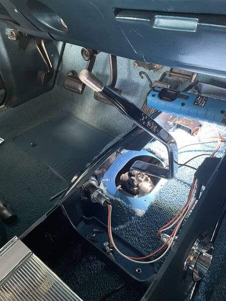

The other day I gave the Hurst Competition Plus 4084 shifter handle one more chance to see if it would work - nope! Using that particular stick basically renders the car undrivable. There's no adjustment that will make it not hit the dash. I'm not talking full throttle bang-shifts but just normal driving. You have to palm it into first and third which is awkward. And, for whatever reason, it just won't stay in gear without holding the handle in place. One quick drive was all it took to put the stock "pretzel" style stick back in. It's a night and day difference. That seems crazy to me but it is what it it is. I really wanted the 4084 shifter to work, the long, flat handle just looks so cool sticking out of the console but it just wasn't meant to be.

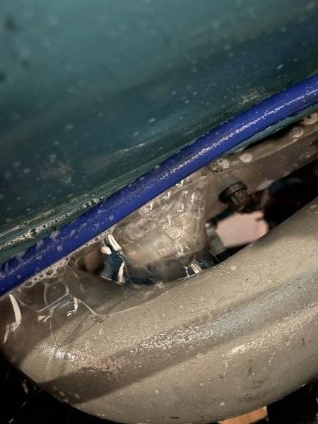

When I was a dealer tech., we would find exhaust leaks using compressed air and soapy water. You plug up one tail pipe, stick a rag in the other and then poke the air nozzle through with a rubber band around the trigger to hold it open. Then you spray the soapy water where you suspect a leak. Depending on the size of the leak, you'll get foam or big soap bubbles. I got all of it.
The worst was the driver's side header between the #3 & #5 cylinders, air was just pouring out as if from an open window with a fan blowing out.

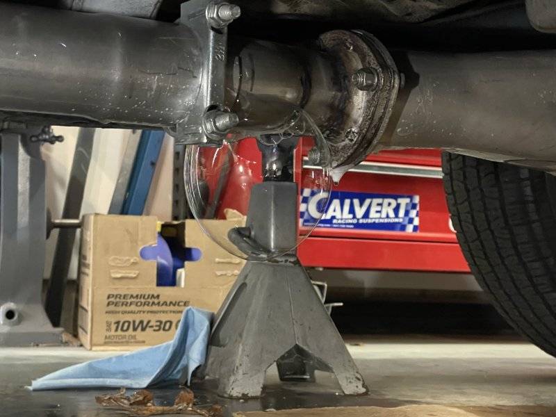

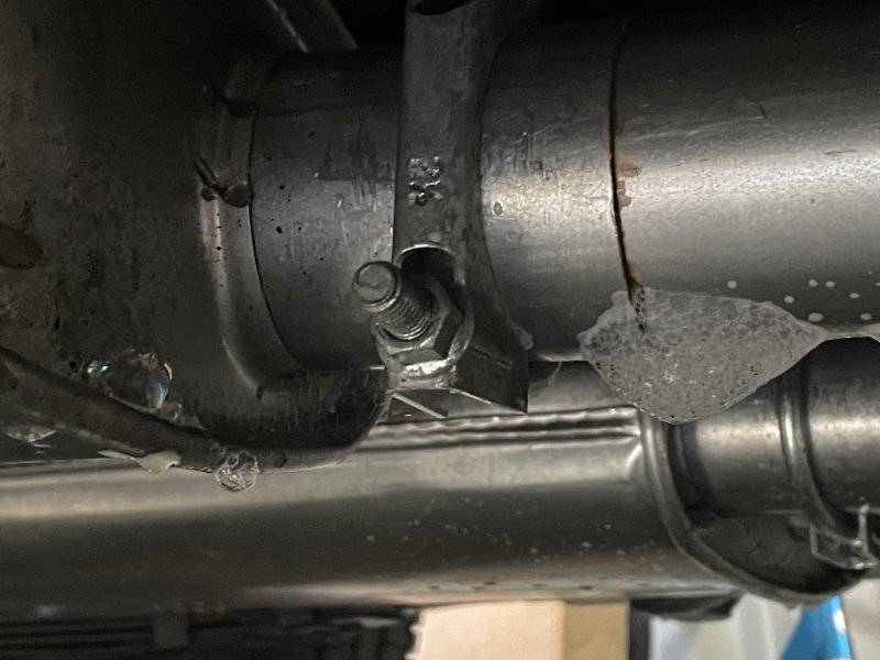

Fromt the back - right-rear muffler and connection. Don't quote me but the bubbles coming from the muffler itself may actually be a pre-drilled hole to let condensation out.
H pipe connection.

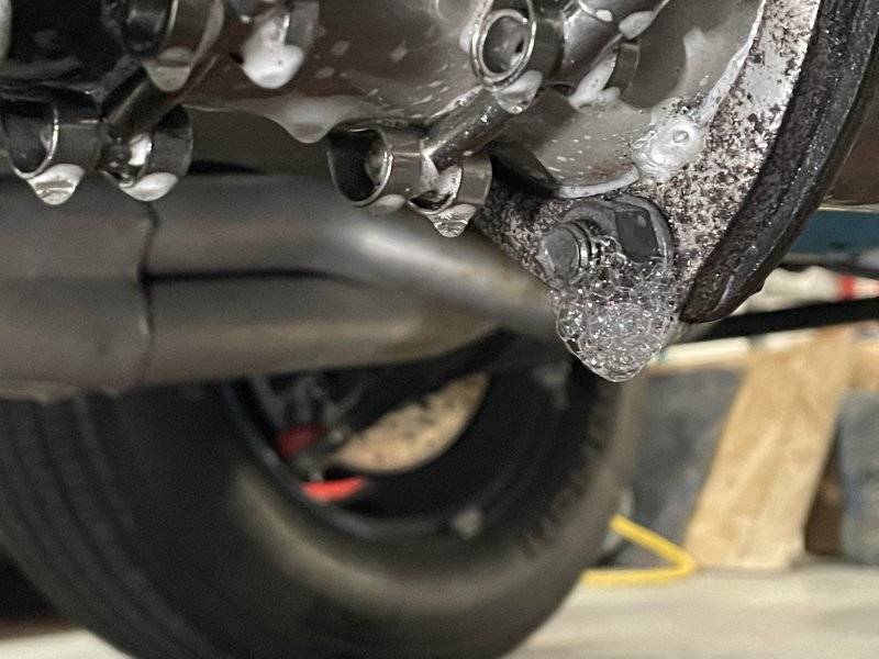

Right-side adapter flange - even the bolt was leaking!
Driver's side adapter.

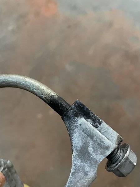

Not a fan of these clamps at all. Pretty sure these were at least partially to blame for the leaks at the joints. They become cocked when you tighten them past a certain point. Once that happens it ovals out the tubing and creates gaps between the surfaces. It's really hard not to overtighten them though because they're not effective when they're just snug either. Junk.

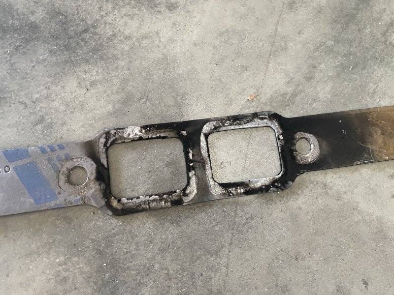

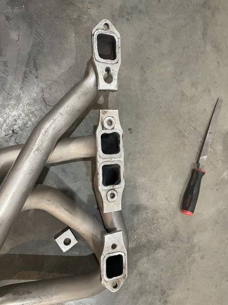

The first solution to these exhaust leaks is to cut the header flanges. Over time they warp (duh!) and cutting them allows the individual primaries a little more flex to seal. 30 seconds with a cutoff wheel and it's done. I even filed the cut edges. When I put the headers back on I noticed it was much easier to thread the bolts in which basically confirmed cutting the flanges was the right move.
Step two was to make sure these raised/welded areas that touch the cylinder head are flat. You can see how uneven they are. It's never going to be perfect...
This is after a bit of time with some emery cloth and a flat file. A little better.

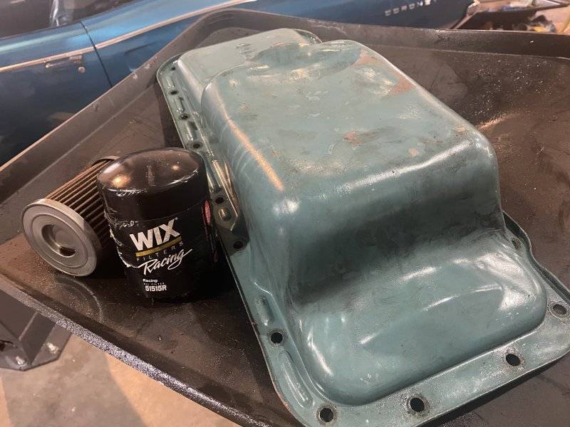

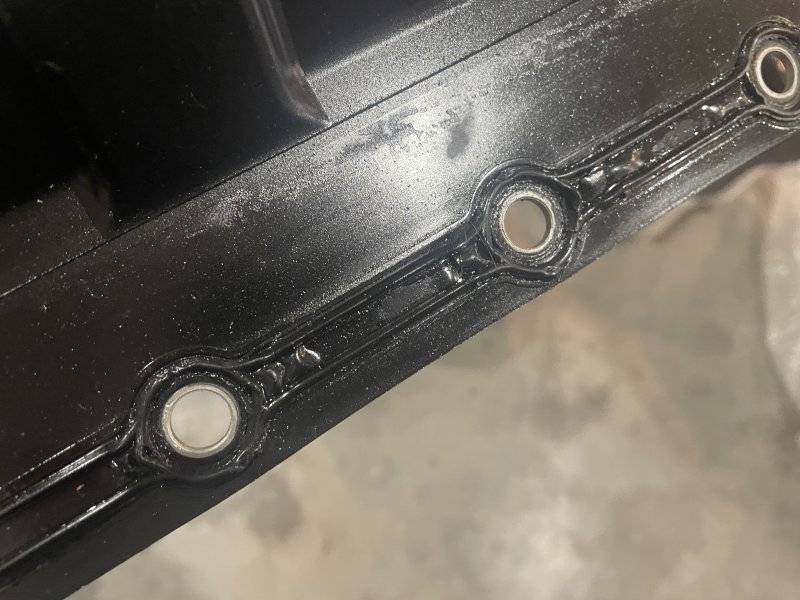

This pan has seen better days. No metal in the filter.
My theory about the leak is that the pan rail is not straight and neither is the block. No, it's not because the pole jack is crushing it, the pan has been leaking since the day I got the car in 2018. It's the same thing that happens with the headers - the fact is, two irregular mating surfaces are not going to seal hot fluids efficiently. Over the last couple years I've tried several different gaskets and all of them leaked including the modern molded type.
I'm still a believer in the molded windage tray kind but I think they're only good on oil pans with flat rails. You can see how the seals got blown out which is most likely from me over-tightening it when trying to stop it from leaking....
As mentioned, I ordered a new 402 pan from Mancini with a Superformance gasket. I will admit that I've used these gaskets before and they leaked. However, I attributed that to what looked like a home made windage tray I used from another motor. I should have known better, it was all bent up and a little thicker than what I thought was normal so nothing would have kept the oil in that time.

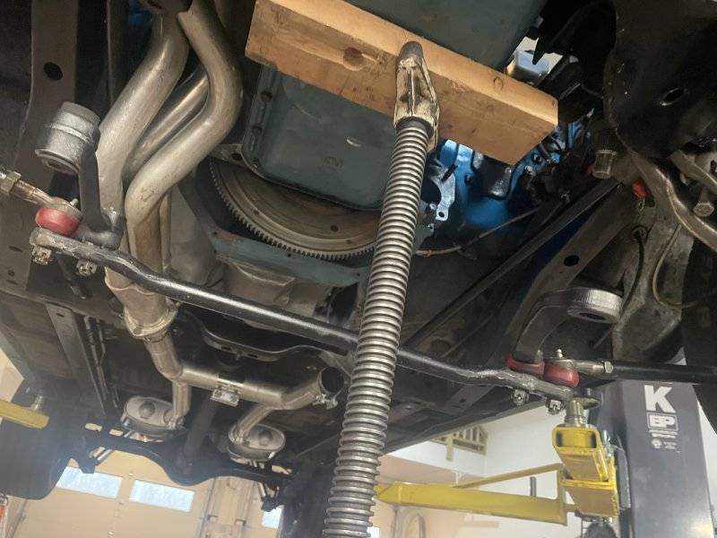

Once the dipstick tube ordeal is over, the pan can go on and I can put the steering linkage back together. Then I'm going to clean the throttle body thoroguhly, get some new spark plugs and make some new plug wires to replace all the burned ones (four!).

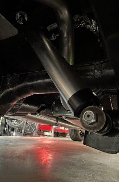

While under the car, I took a look at the rear suspension which had really started to creak towards the end of last year. Amazingly, everything was loose. I was pretty upset with myself but at lest it's all tightened up now. Just about every fastener had come loose - the shackle bolts, the leaf spring U-bolts, the lower shock bolts... Ugh. I have to keep better tabs on this stuff. The rear shocks were loosened one click since it was riding pretty harsh. Didn't touch the fronts though. Thankfully all the fasteners in front are still tight.
