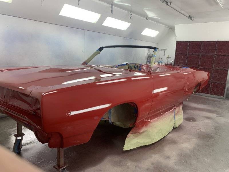

Tag or not, my final decision is the car will be PP1 again (someday) because of this...Didn't lose it.... It's in his sock drawer...
