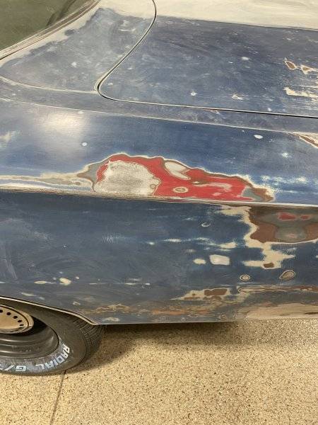

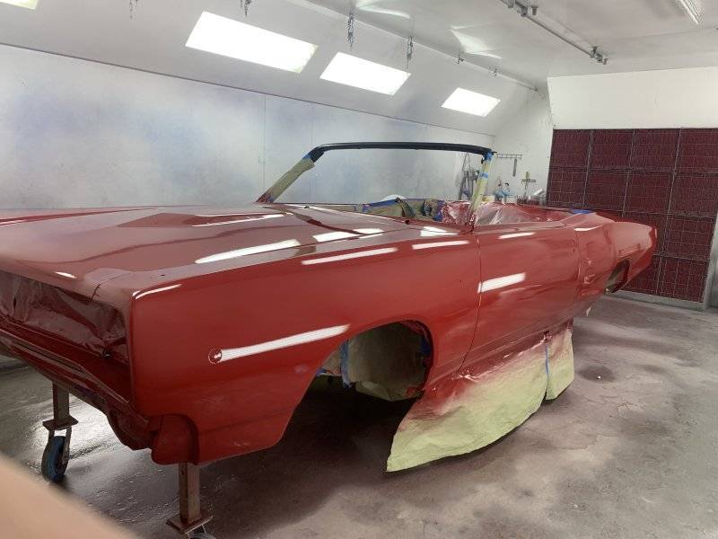

Cool car... I wonder who's it is...Tag or not, my final decision is the car will be PP1 again (someday) because of this...View attachment 1398287
And I don't even like Red....Cool car... I wonder who's it is...Tag or not, my final decision is the car will be PP1 again (someday) because of this...View attachment 1398287
And I don't even like Red....Yeah, I wonder. I never liked red either, then I saw yours, another one on FB, and the little bits that keep poking through on mine, and decided I do like this particular shade of red, combined with points for being the factory color. Need to figure out best place to buy paint now as the local place switched management and suppliers, and then generally went to crap.Cool car... I wonder who's it is...![]()
With my missing fender tag and no long term prior owner info, I can't say too much about original parts. I know it was originally PP1 based on finding it in every nook and cranny. I believe that it was an original AC car because of what is left on the car. I used to hope that the engine was original, but it has no HP stamp and no VIN. It is period correct though. My biggest, pleasant surprise was finding the padded ash tray door jammed in the back seat cushion. I thought it was gone and those things don't appear to be cheap. I don't mind spending money on the car, but not on stuff like ash tray doors. I don't even smoke. The 150 speedo is still there but I am replacing that with a Dakota Digital.

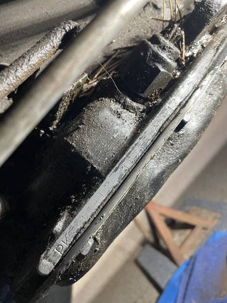

Good to know. Thanks.742 = the large stem pinion...![]()

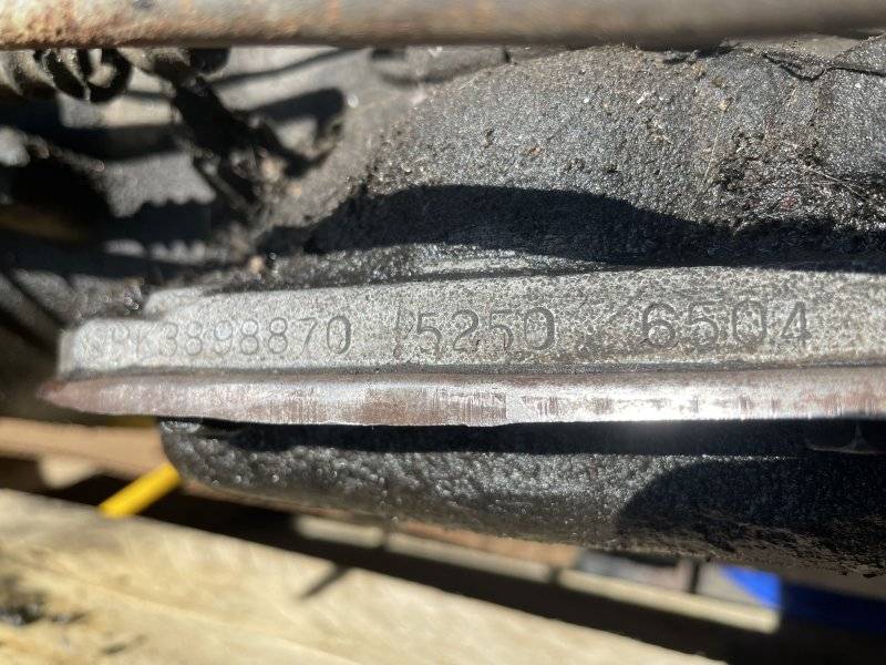

To be honest, automatic transmissions are not something I have much knowledge about. My other option is the transmission I pulled from the Winnebago (a 1976) that has the GV overdrive. One of them is likely being sent to a shop. Here are the numbers off that one:Looks like the correct axle for the car.
Not the trans, but the '71 up with the wide bushing front drum are nice because the billet drums are designed for that pump/stator support.
