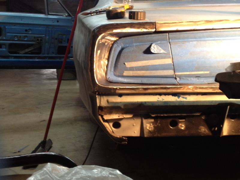

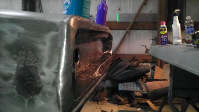

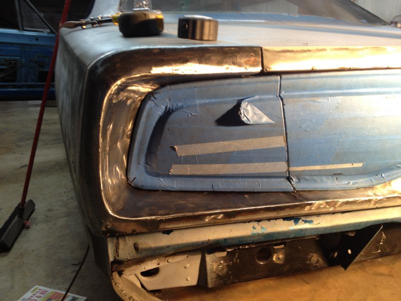

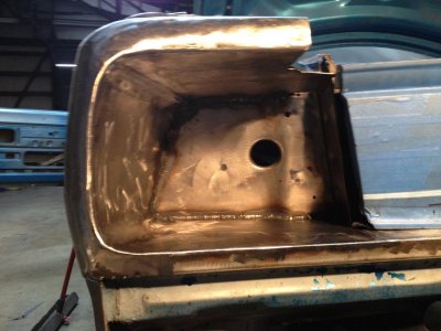

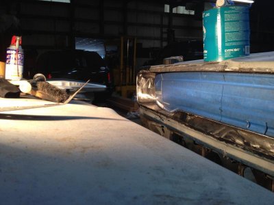

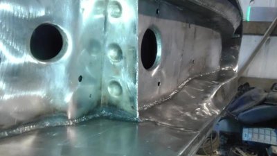

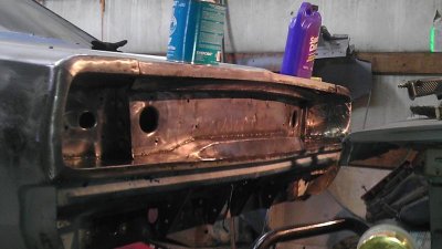

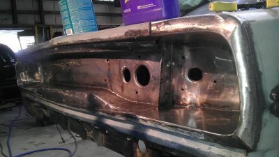

Latest update on what I got done. Should be done soon.
That is some crazy lookin fabricating that you're doing! I said it before and I'll say it again, I can't wait to see this one done. That is some awesome work you're doing and it's going to look killer when its done. What color is the car going to be?
I was interested to see if the outer edges of the tail light would look out of place against the shape of the quarter extension, but you've done an awesome job so far blending the two. Looking forward to seeing it finished! What're your plans with the rest of the car?
I think those taillights will look better on the back of the Coronet than they ever did on the new Charger. Thank you for doing such quality metal work. This SOUNDS like the kind of job an amateur might try. It IS the kind of job that should only be done by someone with mad skeels.
Thanks guys. All the metal work I did is with a hammer, dolly and a vise. The paint is goin to be Copperhead Pearl 2013 Charger LC/FLC
Looking absolutely Great! Keep up the good work and keep us posted on the progress, you have done a fantastic job so far.

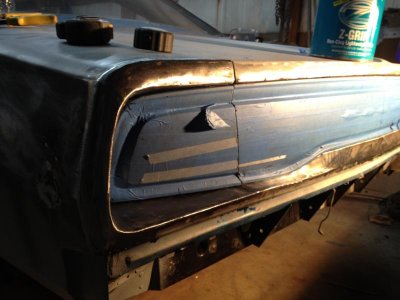

Finished pretty much all the fab work today. Ran out of welding wire.
That's crazy!! I can't wait to see this finished, I think it's going to look good :headbang:
