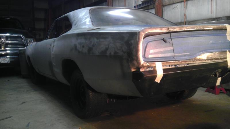

68 Coronet w/ 2012 charger tail lights
Hmmmmmm. Coronet body, Charger taillights, and now Challenger headlights. If I didn't know better, I would think you are trying to make a new breed of muscle car. But Doggone it, it's going to be cool to see it.
I'm looking forward to seeing this thing with the headlights and taillights in it. Very nice work on the rear panel
It's starting to sound like one very cool MoPar for sure :headbang:

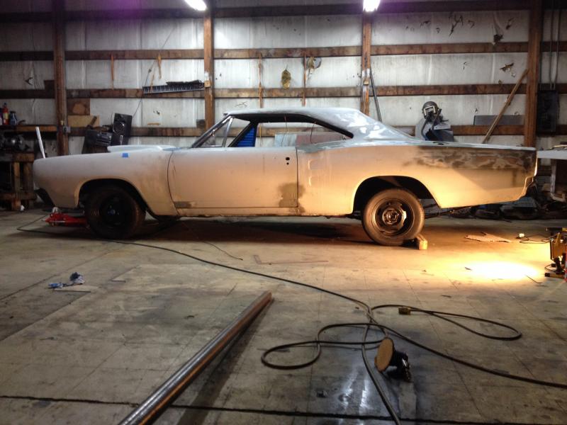

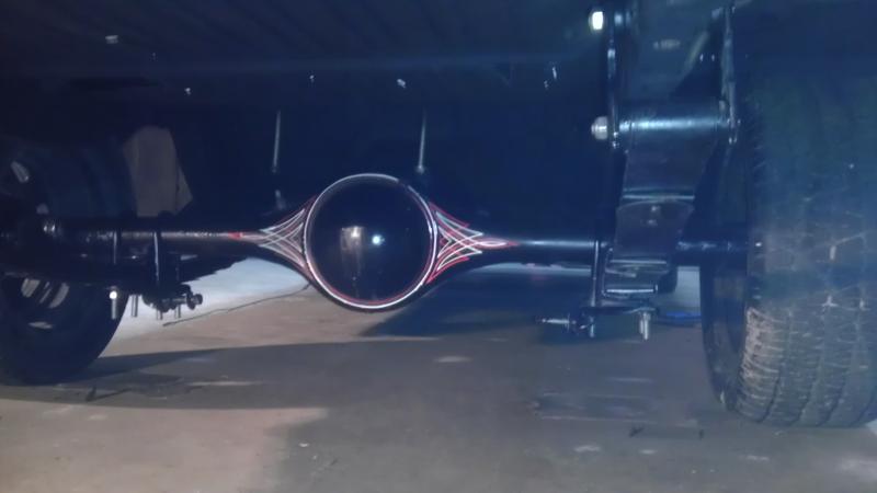

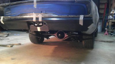

Big day today finally got the car on wheels.

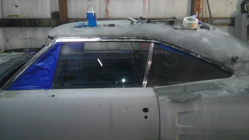

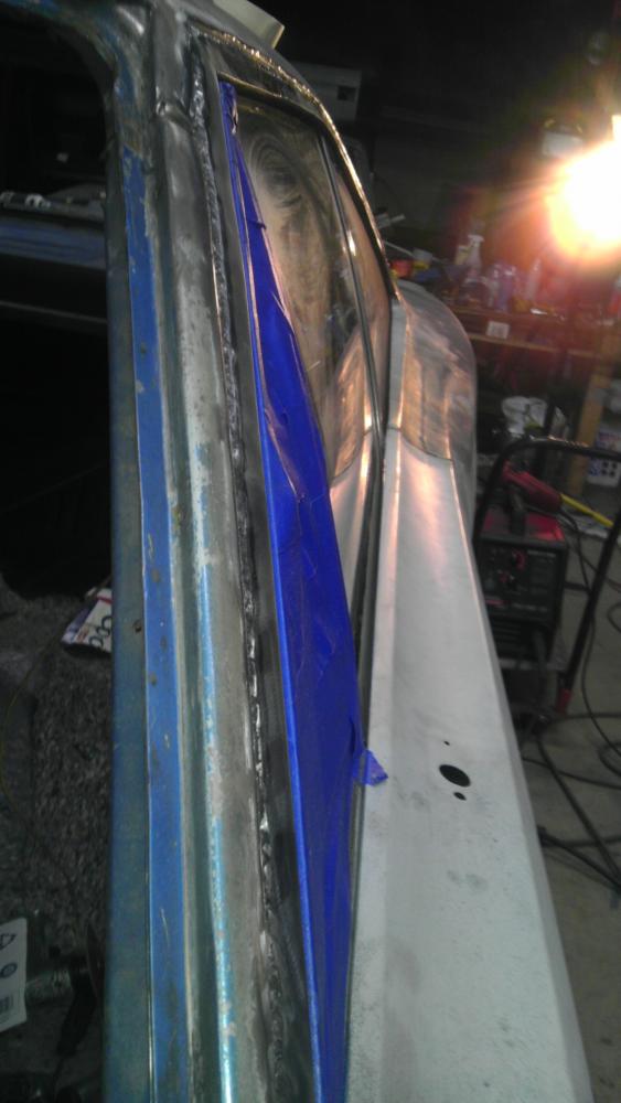

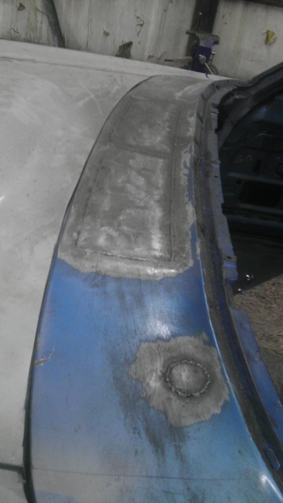

Finished shaving the drip rails and the cowl last weekend. Picking up the Wilwood rear kit tomorrow so I can measure backspacing for 15x12 cop wheels and Hoosier radials. I will have pics of the grille soon, planning on starting it next weekend. Thanks for the input. Thinking about running lowering blocks in the rear to get the stance right, we'll see once I get weight in the car. Running 440/hemi springs w/ a 29x15.50R-15LT

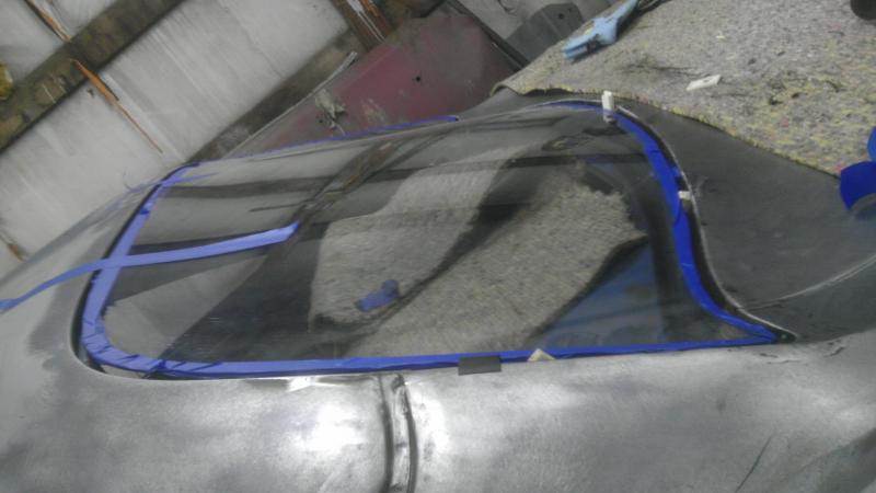

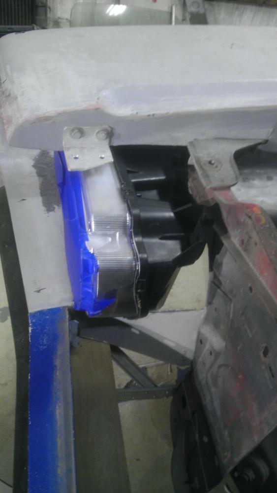

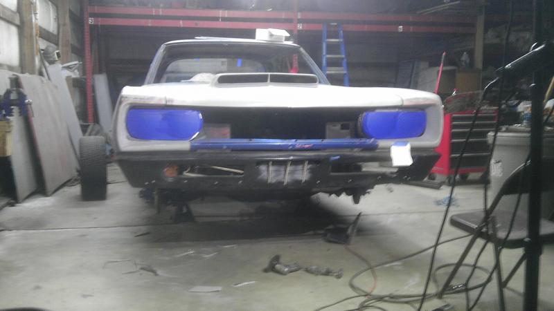

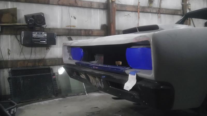

Finally stated working on the Coronet again! Mocked up the flush mounted rear glass, and stated on the new Challenger headlights. I should have the grille in place next weekend. Ill have more pics soon.
