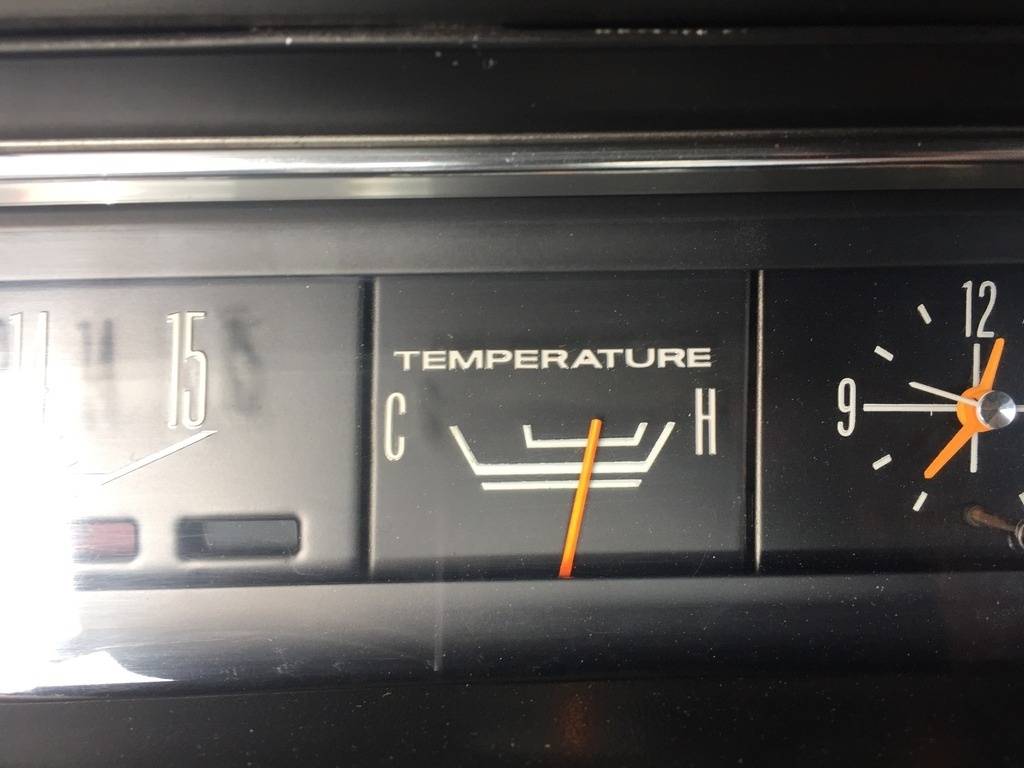

Now the gauge runs to the right of where it did before, right in the middle of the inside brackets.
Now I'm think I clogged the radiator with Bars Leaks. I guess my question is - Where on the gauge is normal?
Reference picture of the gauge:
"right in the middle" of the normal band is "normal"....... if it creeps to the hot side, you have issues
I would hook up a good mechanical gauge for an accurate number, you may be worrying over nothing...... and no more snake oil

Thx for all the replies. I'm assuming based on the stock gauge its hot, but I really don't know if it is. Bad title I guess...
It's burped for sure. Weeping was between the water neck and housing and at both heater hoses engine side. Radiator cap is a new repop 16lb. Builds pressure for sure. I do need to add analog gauges so I can see the temp.
Thx for confirming the needle range for normal. If right in the middle of the center brackets (just past straight up) is normal then I'm right on. I'm okay with the car running over 200* if it wants. I just thought it was odd that it was 'normal' (needle straight up) and then I had the gauge out AND did Bars Leak then all of the sudden the gauge reads to the hot side. Also, it never boiled over or anything either.

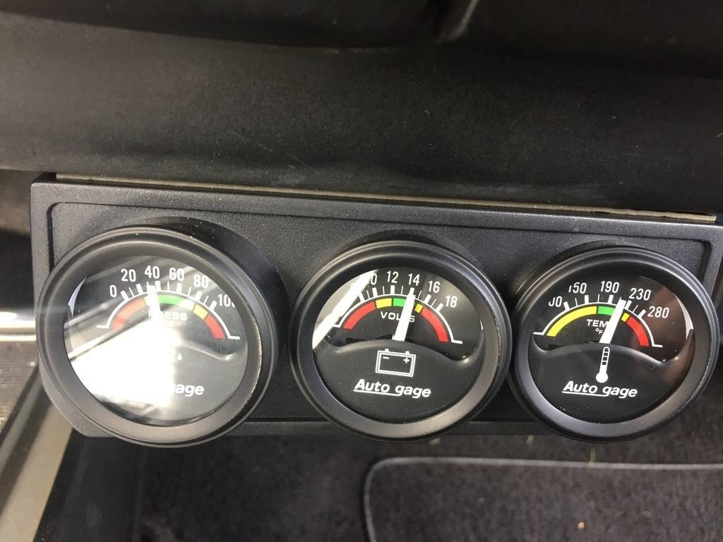

I have an update... this week I picked up a couple things, temp gun and gauges.
I have more data but I think I still have an issue. I did not flush anything yet.
Ambient air temp was around 70* today. I went for a good drive, 10+ miles and beat up on it a hand full of times. Then I let it idle for probably 15 minutes.
Upper hose with the temp gun right at the thermostat housing was 200* and the lower hose at the radiator was 150*. Pictures of both gauges below. I'm wondering if the thermostat is not opening. It's not crazy hot but it was only 70* out today and I would think it would run closer to 190* all the time. Based on where the gauge, dash, was happy before that's where it was.
Still something going on...
You could be right on t-stat bad, but it oughta be puking out rad.cap. Lower hose has spring in it?(collapsing?)

Thx guys. It's not hot enough to boil over yet. The lower hose was not collapsed and the system has pressure once it hot.
The circulation look like an issue looking in the radiator once it was hot when I was making sure the air was out. Usually it will look like the coolant is moving around once the thermostat opens but this looks stagnant like there's no flow.
I'm going to flush it and take the thermostat out this weekend and run straight water in it and see what it does once I confirm the thermostat works.

If you have no flow I would pull the thermostat or replace it.
