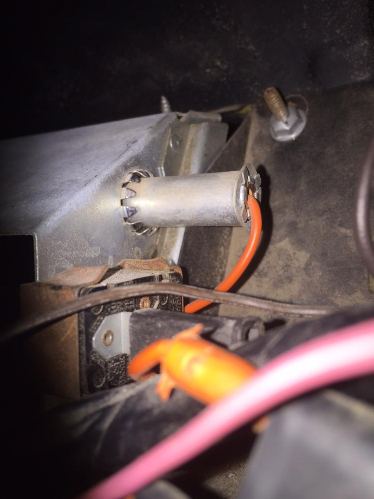

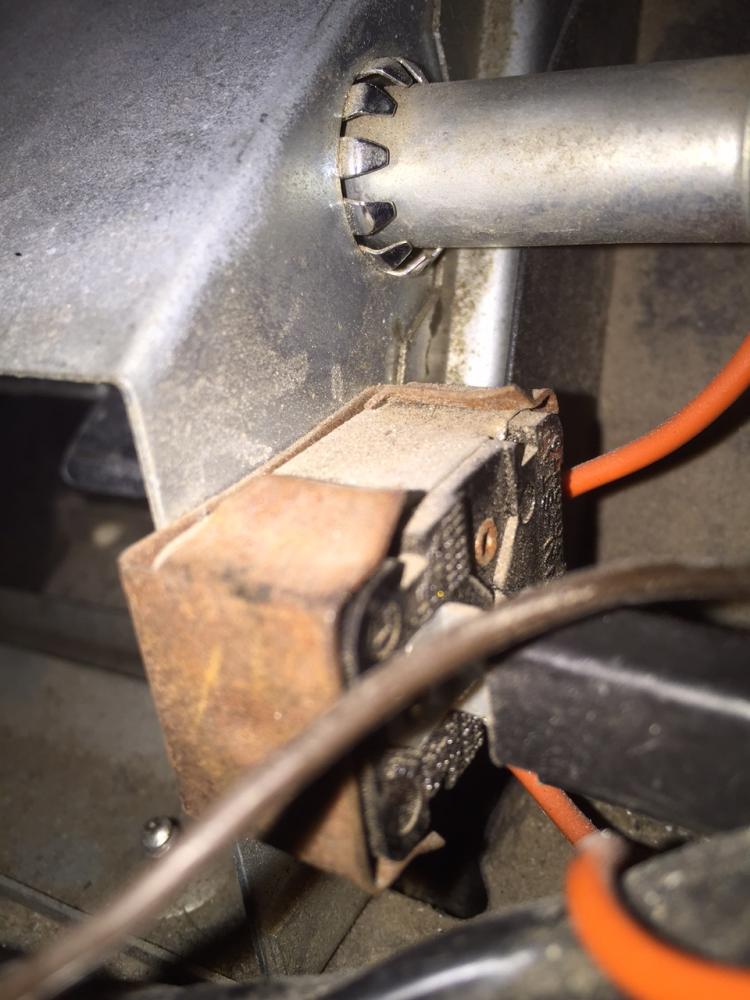

I just went through this myself and had a really hard time finding the flasher. I ended up using my phone to take pictures under the dash. My turn signal flasher was plugged into a receptacle on the driver side of the ash tray (the hazard flasher on the passenger side). I've attached two pictures that show the flasher in the little receptacle. Hope this helps. IMG_0243.jpgIMG_0246.jpg
I just went through this myself and had a really hard time finding the flasher. I ended up using my phone to take pictures under the dash. My turn signal flasher was plugged into a receptacle on the driver side of the ash tray (the hazard flasher on the passenger side). I've attached two pictures that show the flasher in the little receptacle. Hope this helps.View attachment 252419View attachment 252420

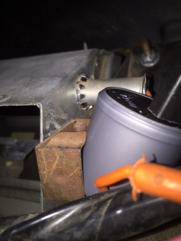

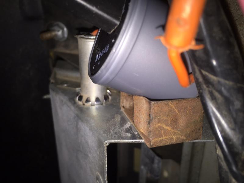

I guess the originals were square. They apparently don't make the square ones anymore - the new one I bought was round. It obviously doesn't plug in to the little holder any more so I just set it next to it. Now it just kind of hangs loose in there.
The new flasher also seems to be quite a bit bigger than the old one. Here's a pic of the new flasher in comparison to the receptacle:

It's directly below the radio, under the dash. The little box is actually attached to the side of the ash tray housing. I found it really helpful to take pictures with my phone under the dash. I was able to move the length of it and try to find the flashers because I had no idea where they went (and I was looking for a round one). I couldn't feel either with them in the housing. I ended up finding both plugged into the receptacle on the ash tray and then looked for the wires coming out of the connectors. The turn signal flasher has 2 wires out of the connector (a red and a black) and the hazard flasher has 3 wires (a red and two pinks, I believe). Good luck!

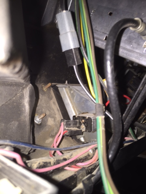

Here's a pic of the hazard flasher on the passenger side for some context. You can see it under the radio and also the wires out of the connector.
