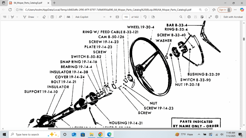

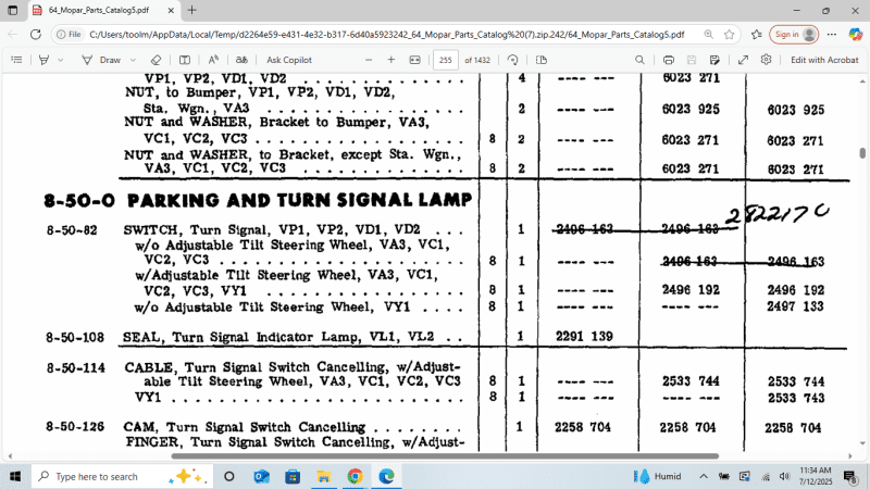

The tag on my switch I took out was #2496163 The parts book above was from My Mopar and I would imagine the #2822170 was a superseded number. Those will give me something to search for any way.
