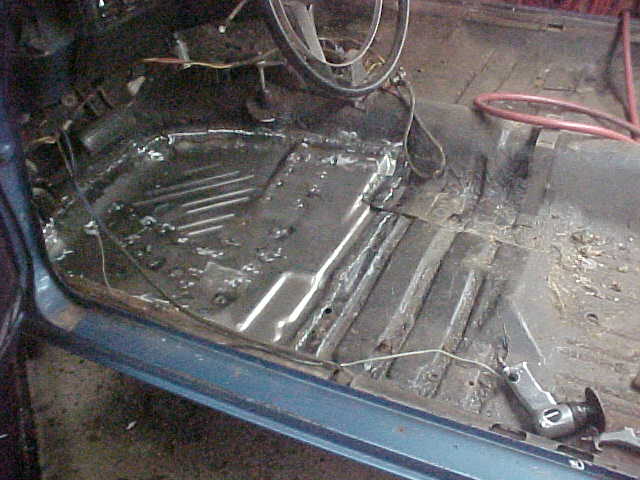

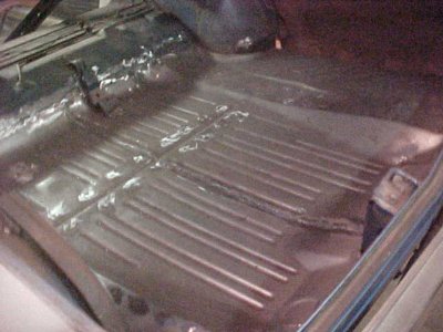

Got some done over the weekend and a couple hours today.Had a little snag in the action over the weekend as my 25+ year old welder took a crap.Ended up getting a Hobart 140.Did get the trunk pans in and welded up.Next i started on the driver side floor pan.Got that out and had to address a soft spot in the torsion crossmember repaired that and installed the new pan today.Next up is the pass side.Also found a pic of what it looked like new to inspire me of what i hope it will look like when done.

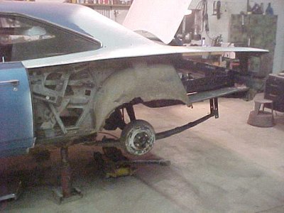

Did get going on the pass side floor,removed and some pretty heavy fabbing on that torsion member end.Pretty much built a T-Cap from scratch by the time i was done,also added some 2x3 tubing on the inside for added strength.Need to finish up the welding on the pan and that part will be history.Then it will be time for the 1/4s.

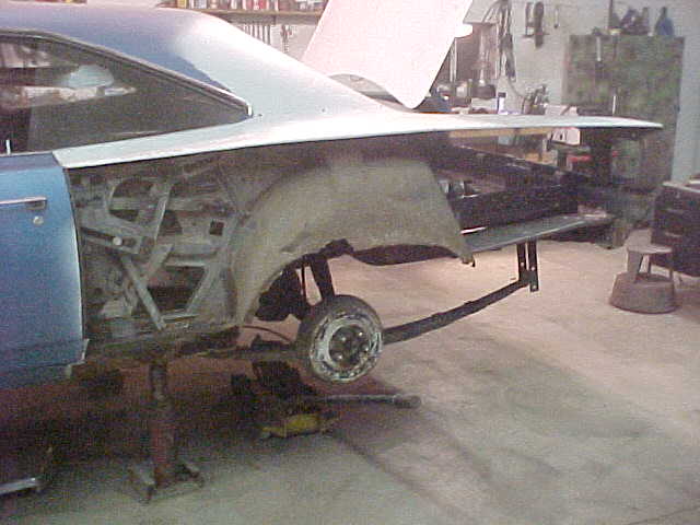

Wrapped up the pass side floor today and did get started on the dr.side 1/4.What a shocker junk wheel house and rusty inner rocker.lol
That will be the next endeaver.I swear this car spent more time on dirt roads that it did on paved ones with the amount of dirt in it.Must of been a half a ice cream bucket in the rear end of that rocker.

I figured it would look like that under that quarter and you're right I was told that it did spend quite some time up north which would have entailed some dirt roads for sure. That would also explain why it is structurealy so clean from the doors forward.

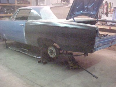

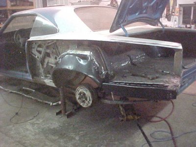

Today went well,repaired the rotton inner rocker.The outer wheel house looked to be a pain in the rear to change it out as the complete unit so i cheated and cut the bad and welded in the new and also got the trunk extensiion in.Have a little prep work yet on the 1/4 but that should be hung tommorow.

Love it when a plan comes together! Damn fine work!

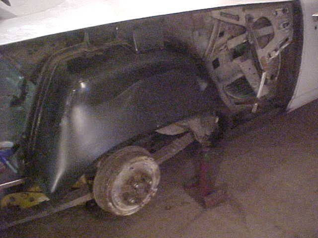

Did get the dr side 1/4 hung and just need to finish welding the top seam up yet.Started on the pass side today.Removed the 1/4 and low and behold more rot.Inner rocker was alittle more of a challenge on this side as it was rotted through the back side also.Lots of dirt again and found my missing seat foam.lol Did get that finished and also got the wheelhouse installed.
