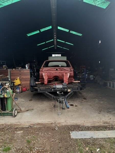

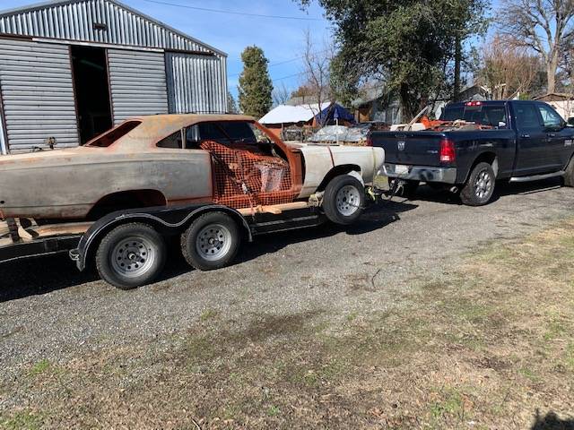

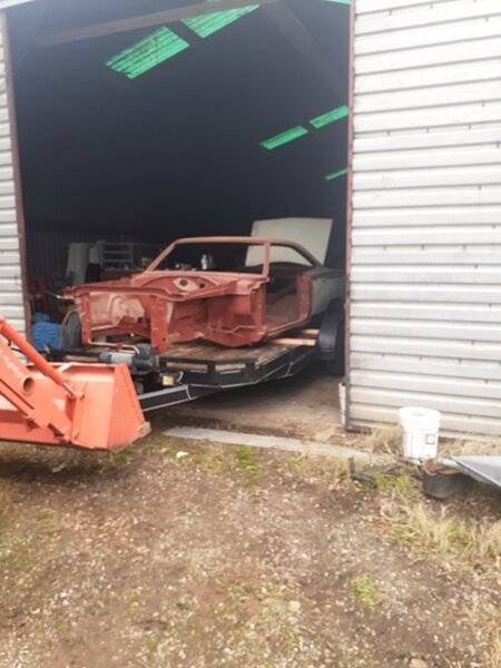

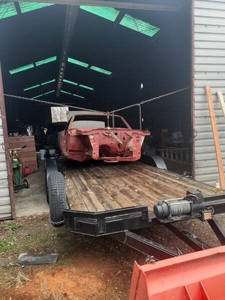

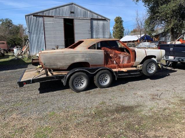

Hi all-Just joined the site this weekend and after posting in the new members area I thought I would start a thread on the project that brought me here. Picked up this 68 RR this week from a guy who had it on a rotisserie in his shop for the last 10 years. He picked it from another guy who was a classic case of someone who found it easy to tear a car apart but didn't have any idea how to put it back together. The guy I purchased the car from was capable but had a shop full of cars and at 75 he was never going to get to this one and finally decided to sell. Most of the car has been blasted and primed with some body work done. Overall there is no rust and one small dent on the passenger side which should be pretty easy to repair. The car came in about 10,000 pieces. Not really sure why it was torn down to the level it was, I will typically not take something 100% apart until I am ready to restore and install that assembly. Minimizes the chance of lost parts. Anyway all of the parts were supposedly there minus the gas tank and the steering wheel. I spent the last 2 days digging through boxes and bins taking inventory and for the most part that is accurate. There is a hand full of missing items (of course they are expensive items like kick down linkage and column shift linkage, ash tray face) but I called the guy I purchased the car from and he has already found some of them in his shop and is looking for the rest. I will try to take plenty of pics and keep this thread alive!

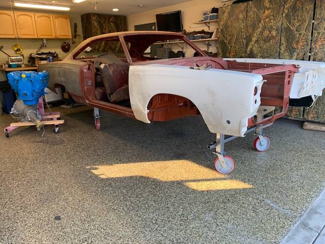

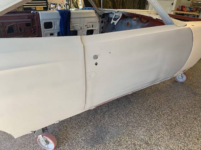

I swore no more basket case projects........my neighbor says it is a disease, of course he has a 32 Ford Coupe in his driveway and a 30 Ford PU in his garage and a 32 Cabriolet in storage and he is 82 years old so I will take his word for it. Anyway I jumped in this week and starter on the RR. The entire car minus the hood and deck lid was at one time blasted and primed with rust inhibiter on the bare areas. First off I took the hood, deck lid and the passenger door down to get them blasted. The door had been soda blasted with rust inhibitor on it but I was not liking it at all, the guy I use blasts with garnet and the parts come back sweet. While I was dropping the parts off to be blasted I was asking the owner about how I should handle the minor surface rust on the roof. Short of bringing it down to be blasted again he suggested a few methods. Discouraging results and after trying several different methods I resigned myself to the fact it was going down to the blaster again then as a last ditch effort I tried something that worked! I had already sanded all of the surface rust off but there was still stains in the metal which means rust is still hanging around so I used some rustoleum rust dissolver worked it in with a 3M stripping pad, wiped it off with a damp rag then followed it with naval jelly. About 10 minutes or so later wiped it down with wet rag/dawn dish soap until clean then followed by a clean wet rag. Then dried it off with a clean towel. I let it set in the sun to dry then took a 3M stripping pad and went over it one more time to remove any flash rust and it came out looking like brand new sheet metal. Hit it with the DA and some 80 grit and it was ready for epoxy primer.

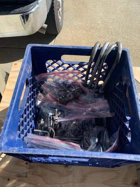

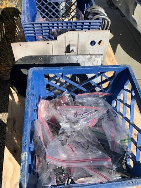

I then moved on to sorting/cleaning/ doing more inventory of the parts that came with the car. As I mentioned "all the parts were there" except they weren't, the majority were but not all. Some stuff was tagged and bagged and some stuff was just in coffee cans. It was pretty random items that were missing. Thanks to FBBO I have been able to score pretty much all that was missing (so far)
. I think taking the time to clean/tag and bag will pay dividends later.
