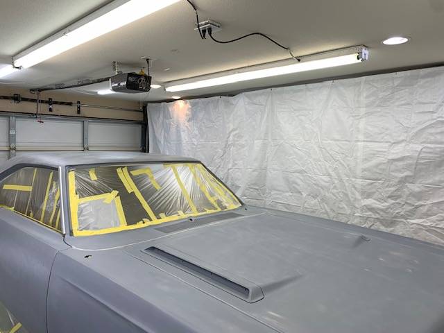

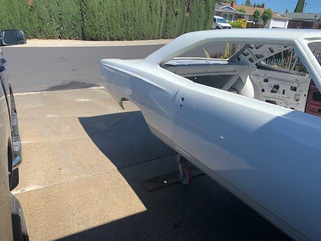

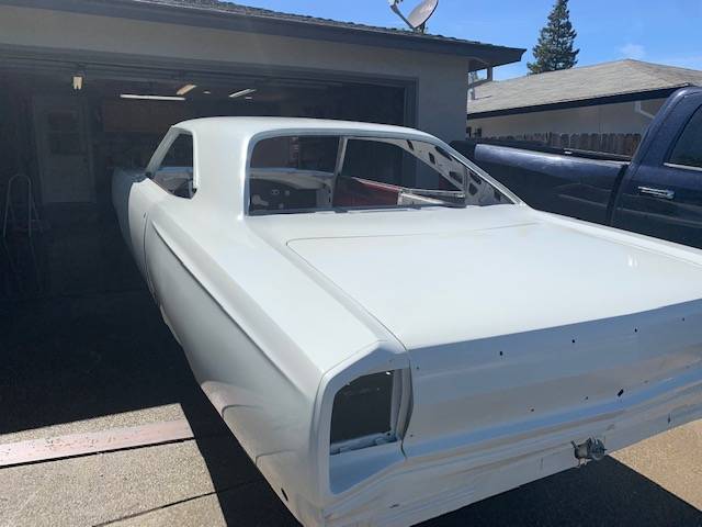

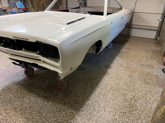

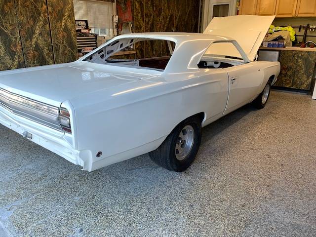

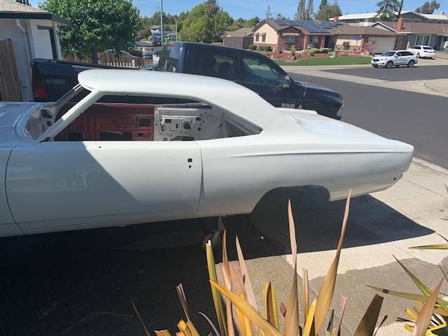

It was an interesting day with several lessons learned (like don't use cheap plastic to mask). My big struggle is to slow down-the last few years I have been involved in building boats and with Gel Coat time is of the essence so I tend to rush, telling myself to relax and slow down is constant. Overall it turned out good but at times I was starting to wonder. Since I don't have the luxury of a shop and I only paint one car every once in a while I put together a makeshift booth that worked out pretty well. It kept things clean and with 2 fans running on opposite ends it kept the fog to a minimum. I am trying something new for me it's called listening......so I am following SPI's "Perfect paint job" write up on there web site by only applying 3 coats of their clear this go around, sand/block on Thursday and then probably Friday I will shoot 3-4 more coats, that is supposed to keep the urethane wave to a minimum. Next week things can start going back together!

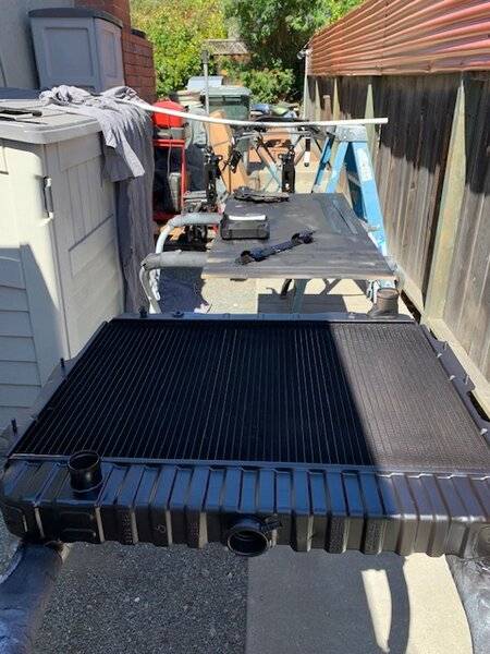

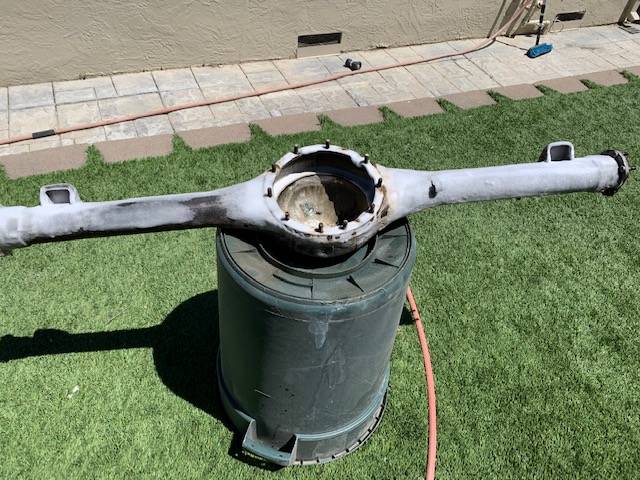

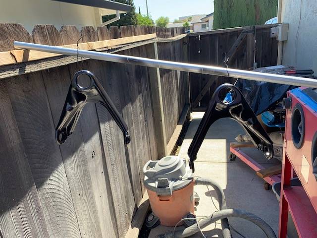

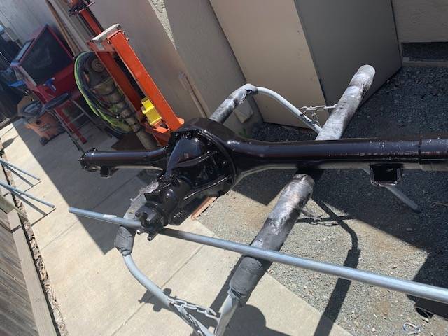

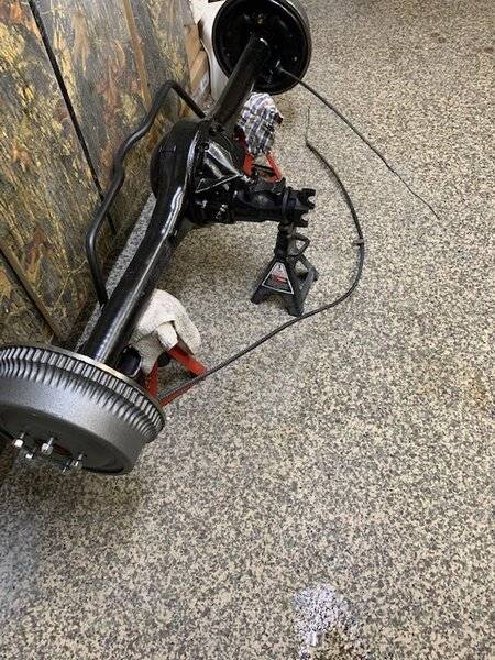

Moving right along I started painting suspension parts this week. Fortunately quite a bit of it was already blasted so it was just a little touch up blasting and paint. The rear end was not cleaned up but some dollar store oven cleaner and a little sanding and it was ready for paint tomorrow. Kinda tight next to the house but I am making it happen...........just have to wait until my next door neighbor goes to work before I spray :lol:.

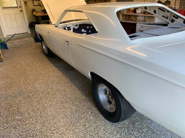

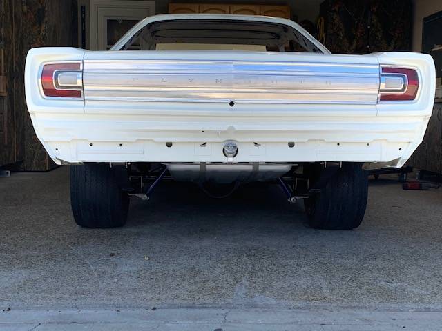

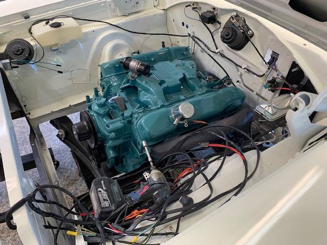

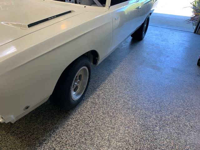

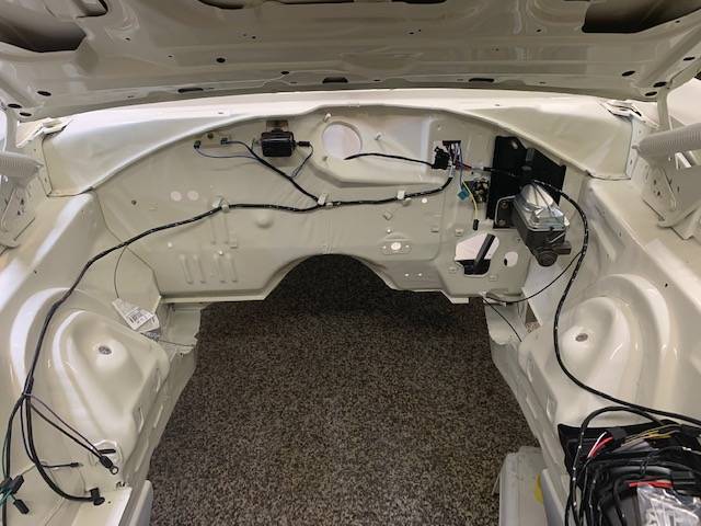

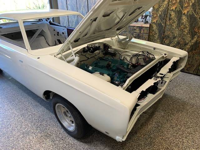

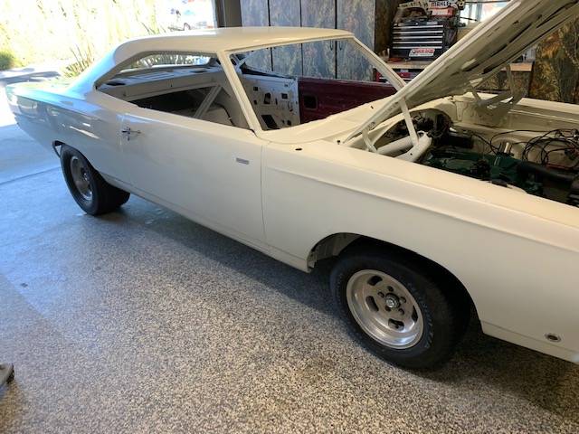

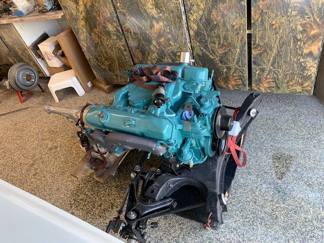

Like many of us I get caught up on what I am doing and always think about pics after I am past the point where I should have taken more pics. Anyway I have been making progress, cut and buffing took the better part of a week and then another week trying to bolt on as much as I could before installing the engine and K member and lowering the car. Bolting the engine/trans/K member together is the cats meow, lifted the car up rolled it under and lowered it down and wala it was home. Rear end was pretty easy I simply put it on a floor jack with a support under the nose and jacked it up above the springs (bolted the front of the springs on before jacking up the rear end) and hinged the rear of the leaf up and then lowered the rear end down easy as pie. The trunk panel is not bolted on just wanted to get it someplace where it was not likely to get damaged while I am waiting for paint to arrive. That is some expensive paint $25 a can! It better be worth the wait. Check out my rollers I picked up on CL for cheap-kinda liking those old school 50's on the rear, lol. Here are a few pics of the past couple of weeks.

View attachment 1128124 View attachment 1128125 View attachment 1128127 View attachment 1128128

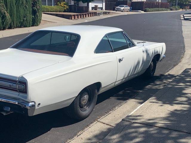

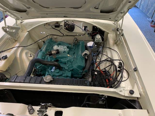

Been crazy the last 3-4 months and have not had the time to work on the RR but finally jumped in this week and got it running and moving under it's own power-kinda hard to drive sitting on a bucket so we will settle for in/out of the garage for now.
